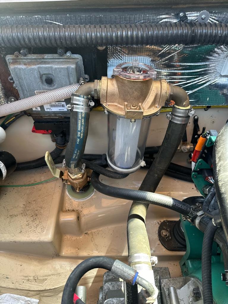

The D3 installed in the Rangers and Cutwaters have a 1" thru hull. 1" hose feeding the strainer and a 1 1/4" hose going to the cooler and the Raw water pump.The required thru hull for a Volvo D3 is 1 1/4". The raw water pump requirement is what ever the size of the raw water pump inlet and outlet are that is the size through should be installed. ( or larger).
With the installation of the 1" the best you will ever see is 193F at WOT. The cooling system does not get enough water flow to operate as per Volvo's design. If the through hull was sized correctly that engine should rarely see 180 F @WOT The thermostat is @178F open If the cooling system is functioning as per design the engine should stay at this temperature at any RPM with a influence only by ambient water temperature.
I have spoken to many Ranger and Cutwater owners that have the D3 200 and 220. All have stated the best they have seen is 193F at WOT with a completely clean raw water system. The best I have seen 192F operating at WOT in Lake Michigan. Water at 55F ambient, first year I owned the boat with under 100Hrs. The boat was operated 400 of the 650 hrs in fresh water. When operated in salt water the engine was flushed any time I was tied up at a marina for the night. When in the warm waters of Florida I learned to except 199F TO 203F with a clean bottom clean raw water system. To correct the higher operating temperatures experienced with the C26 or Ranger R27 with D3 200 or 220, installing a 1 1/4 through hull with no fitting smaller that 1 1/4" leading to the engines raw water cooling system will resolve the issue.

Well, BB was right - my classic 27 had a 1” thru hull that had a 1”-11/4 step up . Hmmmmm
Anyway the yard d and I just did not like the one into three setup - engine cooling should have its own circuit
Here is what we came up with - using a scoop type pickup outside of hull
Sea trials today - 4000 rpm for 20min -
191 degrees
3800 - 3400
184 degrees
Below 3400
178 degrees
Very pleased

The D3 installed in the Rangers and Cutwaters have a 1" thru hull. 1" hose feeding the strainer and a 1 1/4" hose going to the cooler and the Raw water pump.The required thru hull for a Volvo D3 is 1 1/4". The raw water pump requirement is what ever the size of the raw water pump inlet and outlet are that is the size through should be installed. ( or larger)..
Interesting,…a 1” thru hull would be 1” ID…. How do you connect a 1” hose onto a 1” thru hull with an outside diameter of 1:25”?
Also, the inlet diameter to the transmission oil cooler is 1” , necessitating a 1.25 hose ID to fit.
The inlet diameter to the sea strainer is also 1” ID…. The inlet diameter to the raw water pump is 1” ID.
Even with the larger thru hull, the choke point would still be the inlet diameter to the oil cooler….so this doesn’t make sense to me. My 2013 25sc DOES NOT HAVE A 1” hose feeding the sea strainer….
