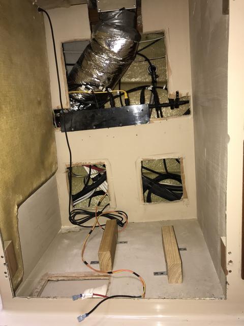

If you pull the refrigerator out you can see the water level gauge and various hoses that attach to the fresh water tank. That might be a good place to start your search.
We have a R29 and had water in the same area when I was having problems with the shower sump. Our sump pump was intermittent and would overflow. Once I got the sump issues resolved the problem went away. Also if I recall your AC condensate drain goes into your shower sump. It may not be inserted properly. Last of all we had a fitting on the cold water side of the shower faucet pop off while under way and pumped our entire fresh supply into the forward bilge. You could have a leaky fitting. I found several loose hose clamps, either from improper installation or shrinkage of the plastic lines over time. This is accessible by removing all the partitions at the front of the cave. Best done on the hard unless your alright with pieces of your boat spread all over.
Good Luck, Leon
This is what was seen with the refrigerator pulled during a project a couple years ago.

The picture you posted of the pulled refrigerator looks similar to what I saw when I pulled mine a few years ago. The hole in the floor was how I accessed the fresh water tank gauge which needed to be cleaned to make it operational again. If I recall correctly, I believe I could also see the fill and overflow lines where they attached to the tank through that hole.

I need to remove the refrigerator to access the NEMA 2000 backbone for another project so I’ll look at the fresh water plumbing as best I can.
