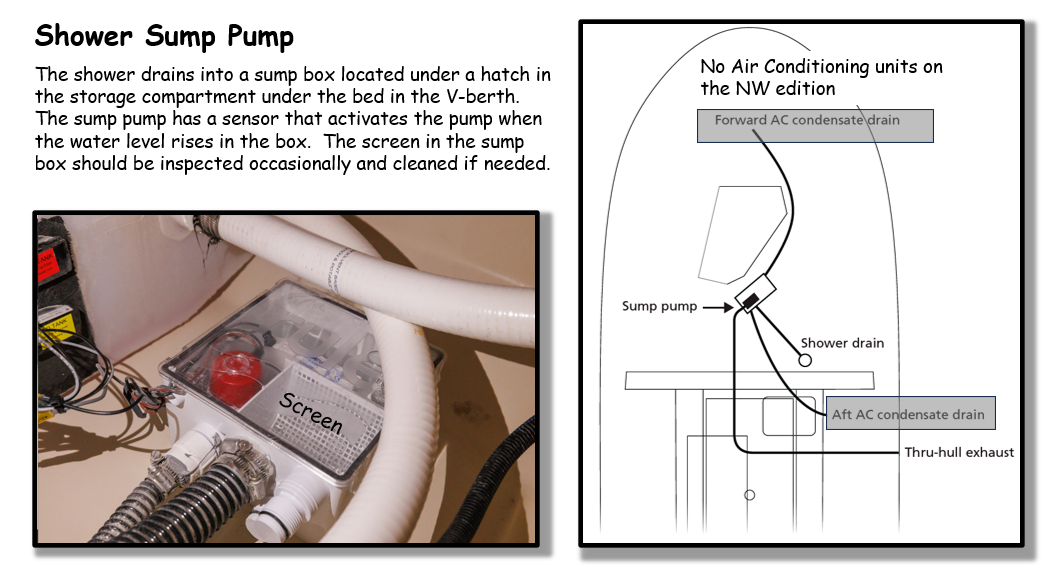

On my 2019 R31CB water seems to run into the shower pump box from somewhere other than the shower.
The pump will run and empty the box however then will slowly refill. I suspect some of the water is back wash from the pump hose.
Another question is what are the two hoses on either side of the hose from hose from the shower.
Any help figuring this out is appreciated.
