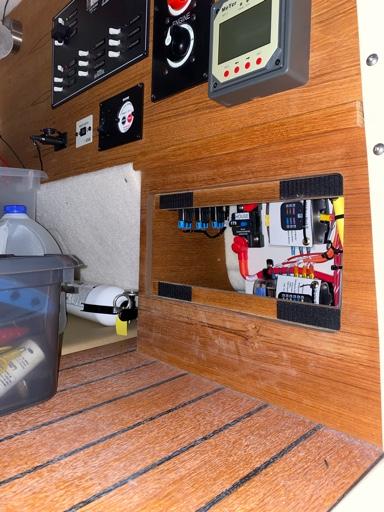

My 2019 27OB was sold and back in NY... But, if I remember right they are down and kinda hidden behind the velcro panel for the 24/7 fuses at the entrance to the cave...
The fuse for the webasto is located in the Q-birth inside the removable wood panel below your engine, parallel, and house switches. The fuse is inside a black cap located on the left attached to the wood wall.

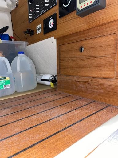

your fuses to the Webasto heater are inside the teak door that is located inside the midcabin. Just like zekeandboone is mentioning below. They should also be labeled, (webasto) let me know if you can find them.

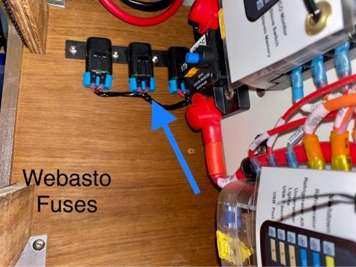

I’m at my boat today. Found the fuses with your help. Here are a couple of photos.
