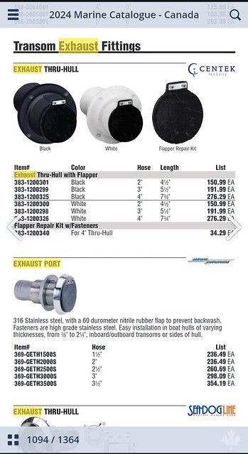

I assume you need the 4" version of the 316 stainless port pictured below?
Any chance there's enough room for the plastic flanged exhaust port?
There's one from Vetus that supports a 4" exhaust hose too.

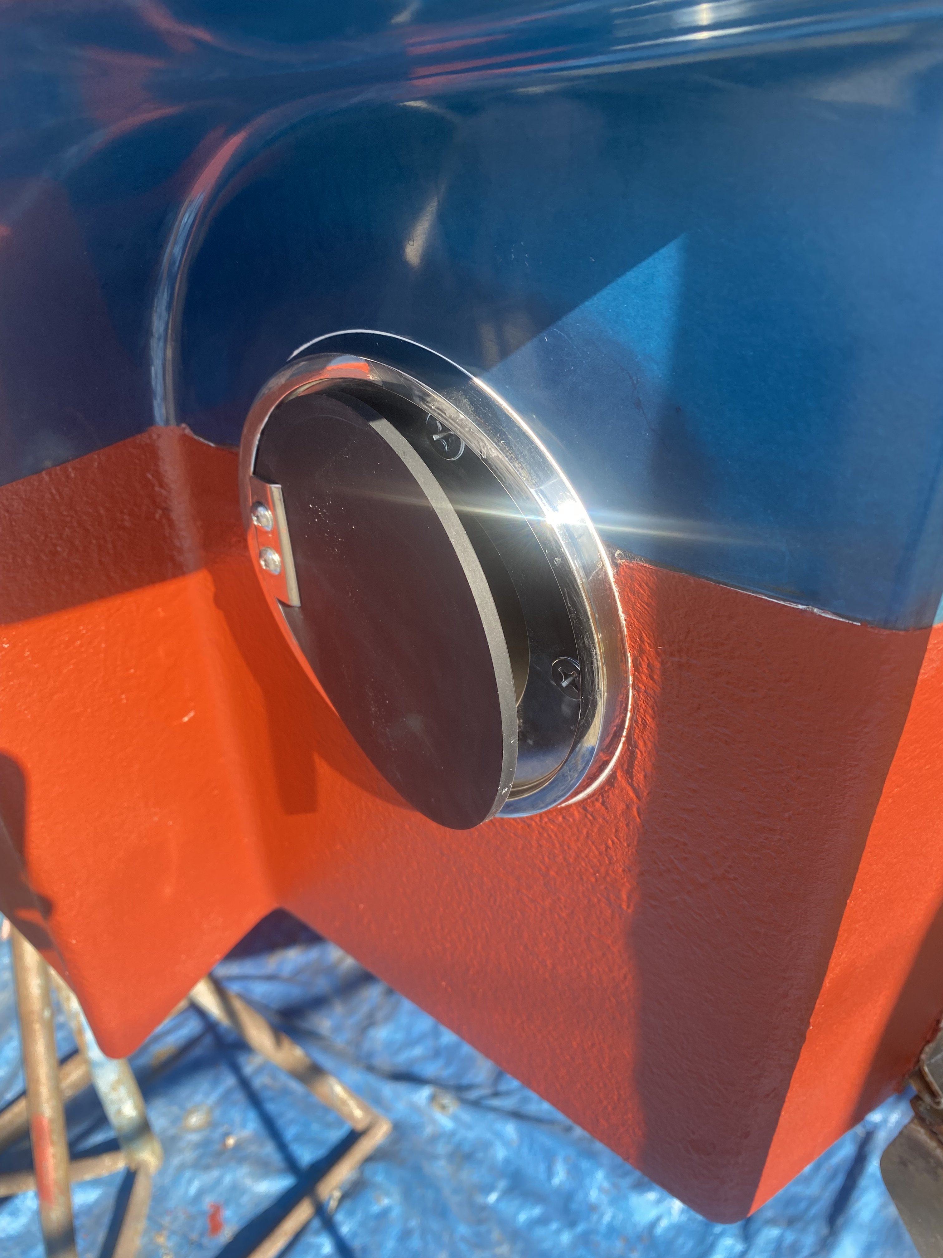

Hi there, I was going to say we have one of these in stock (3 1/2") then scrolled further down and notice the work has been done, happy day 🙂
