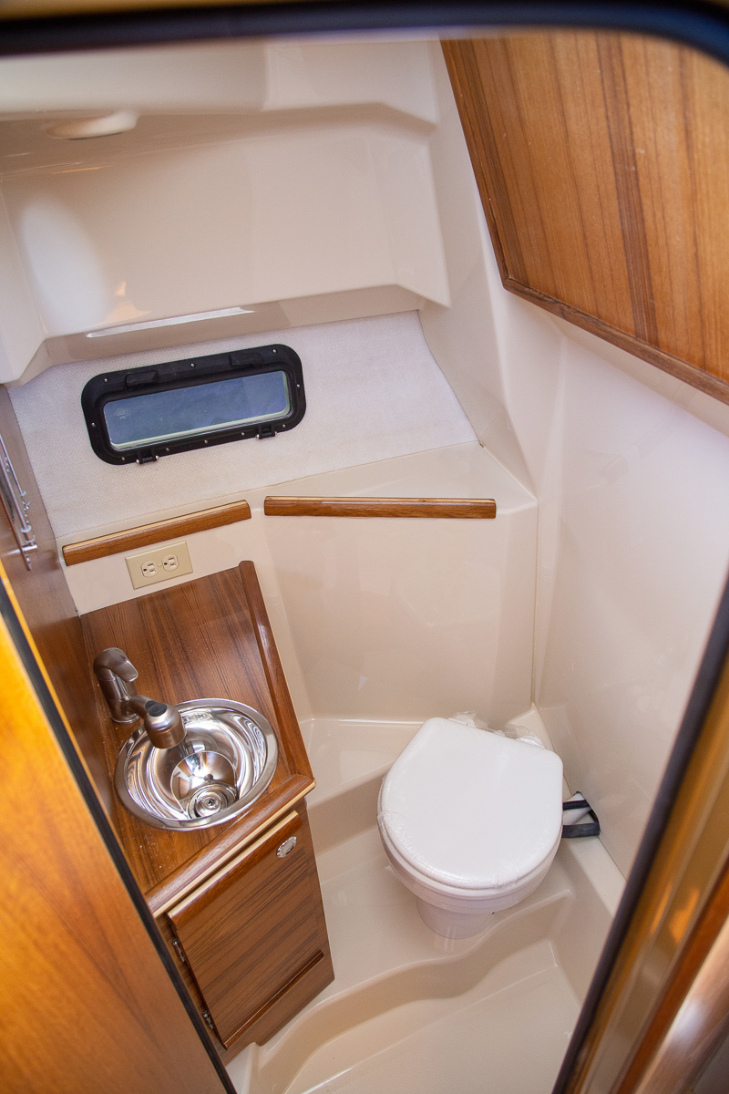

I'm planning to place an inspection hatch behind the toilet on the R25 OB, in the area below the small shelf. I'm planning to install additional electronic components there that can't fit in the helm console. Has anyone done this, and do you have a picture of what's in there? It sure looks like it's got potential for storage/component installation.
Hello,
There is a 1' void behind that wall between the wall and hull. The only issue that may arise is hitting the wires/pex behind that wall while cutting the hole. The only way to be certain about where those wires/pex are, is to stick your phone or a borescope into the hole on the stringer where the head sink drain is passing through (inside the cabinet).
