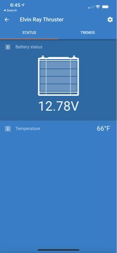

For about $40, you can monitor the battery voltage from anywhere on the boat.
Victron Energy Smart Battery Sense Long Range (up to 10m) https://www.amazon.com/dp/B07RTYGMBD/re ... FLqajujGi5
