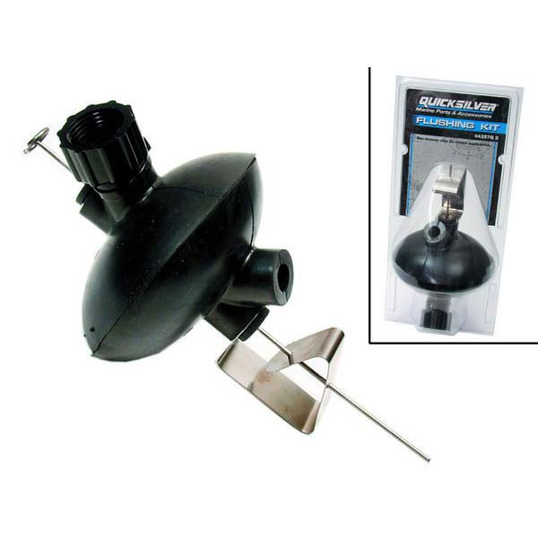

This devise is made from using half of the devise below (link) and bending the wire rod to make a hook to attach to the grate on the thru hull fitting on the bottom of the boat.
https://cdn3.bigcommerce.com/s-6rtev5ow ... 80.jpg?c=2
I made this up for flushing the engine and raw water wash down. It attaches to the thru hull pick-up on the bottom of the boat. It also works for the marine air unit attached the same way. I have a small 120V pump and place it in a small kiddy pool ,slide it under the boat pour -50 propylene glycol in the pool, place a bucket near the discharge fitting on the side of the boat to catch the anti freeze, plug the pump in ,pour a small amount of pink in the strainer to prime the pump, put the lid on. I turn air unit on, when pink comes out of the side hull fitting, air unit off, winterize complete. I then move the pool under the engine/raw water wash down thru hull ( bottom of boat), attach the flushing devise to thru hull fitting grate, 6 gallons of -50 propylene glycol in pool, place a 5 gallon bucket under exhaust outlet at stern, turn pump on, take cover off the strainer fill with pink( takes about a gallon), install cover, start engine, when pink starts coming out of exhaust shut engine down. I put 3 more gallons in the pool turn raw water pump on and when pink comes out of hose that system is complete. I finish with starting engine again and run for approx 30 seconds to insure a good concentration of -50 propylene glycol is in the freshwater cooling system of the engine ( muffler holds the most) All sea water components are now winterized. Doing this by myself takes about an hour. That is set up , winterize and put everything away. No hand tools needed! Note: always insure there is adequate anti freeze in pool, don't let it run dry. I start out with ten gallons of antifreeze. This is enough to do raw water system and fresh water system. I by pass the hot water tank so no anti-freeze is used for tank. I try to catch as much antifreeze as I can after it is discharged so I'm not wasting it. I reuse it for the engine raw water system only.
