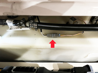

We asked the factory about this and Kenny Mars said he's "never needed to recalibrate a fuel sender". Ivan also said they don't calibrate the sender and wondered if the connectors on top of the fuel tank (visible when you lift the center lazarette) might have been loose and if the tech disconnected and reconnected them? If so, hardly required 2 hours of servicing!
