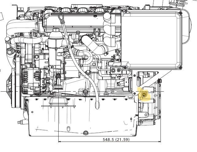

A couple of weeks ago while running at max engine RPM, the engine warning light and beeper came on. After slowing down and stopping the engine it indicated low oil pressure. It turned out that the engine had spit out all the oil, and it was now in the bilge mostly on the port side. I managed to pump the oil into a bucket before the bilge pump pumped it overboard. Back at the marina I pumped out the remaining oil from the engine, replaced the oil filter and started refilling the engine. After 12 qts it still did not register on the oil level stick. and again the oil was in the bilge. I have been trying to find out where the leak is. It has to be in the oil pan since it did not show up on the oil stick after adding 12 qts, and it has to be a fairly substantial hole since the cold oil I poured in ran out fairly quickly. I managed to look at the port drain port with an endoscope and the screw was still there, so that was not the cause. It is difficult to get the endoscope under the oil pan and low on the starboard side of the engine. Probably need to lift the engine some to get a good look. I replaced the oil 11 months ago and had no problems until now.
I wonder if anybody has had the same experience or have an idea what failed?

I finally located the source of the oil leak. The engine is made by BMW and Yanmar modified it for marine use. Left over from BMW is an oil pressure sensor located below the oil filter and out of sight. It is not used in the Yanmar application. The bayonet nut that holds the sensor had come lose and since this is right at the output of the oil pump it didn’t take long to pump all the oil out. I got great help from the Yanmar specialist at Harbor Marine in Everett WA. He knew about this deactivated transducer, and he mentioned that it was a known problem with this Yanmar engine. After tightening the nut and refilling with oil I started the engine, and the oil pressure went right up to 61 psi at idle. As the oil heated up the pressure reduced to 21 psi at 122deg F. I didn’t have time to see how low it would go at max temperature. The service information calls for 8.7 to 14.5 psi at 1000 rpm, but does not specify at what temperature. I am crossing my fingers that the bearings are not damaged.
