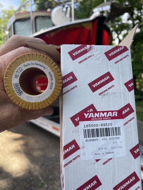

Long story, but I ended up with a Yanmar oil filter after some maintenance was performed on the 4BY2-180 in my 2012 R27 earlier this year. Before stowing it in my parts storage drawer, I opened the Yanmar box to inspect the filter. The filter Yanmar puts in their box is a Mann HU-722. So if you’re doing an oil change, buy the Mann filter for $13 instead of paying Yanmar five times as much for the exact same filter.
