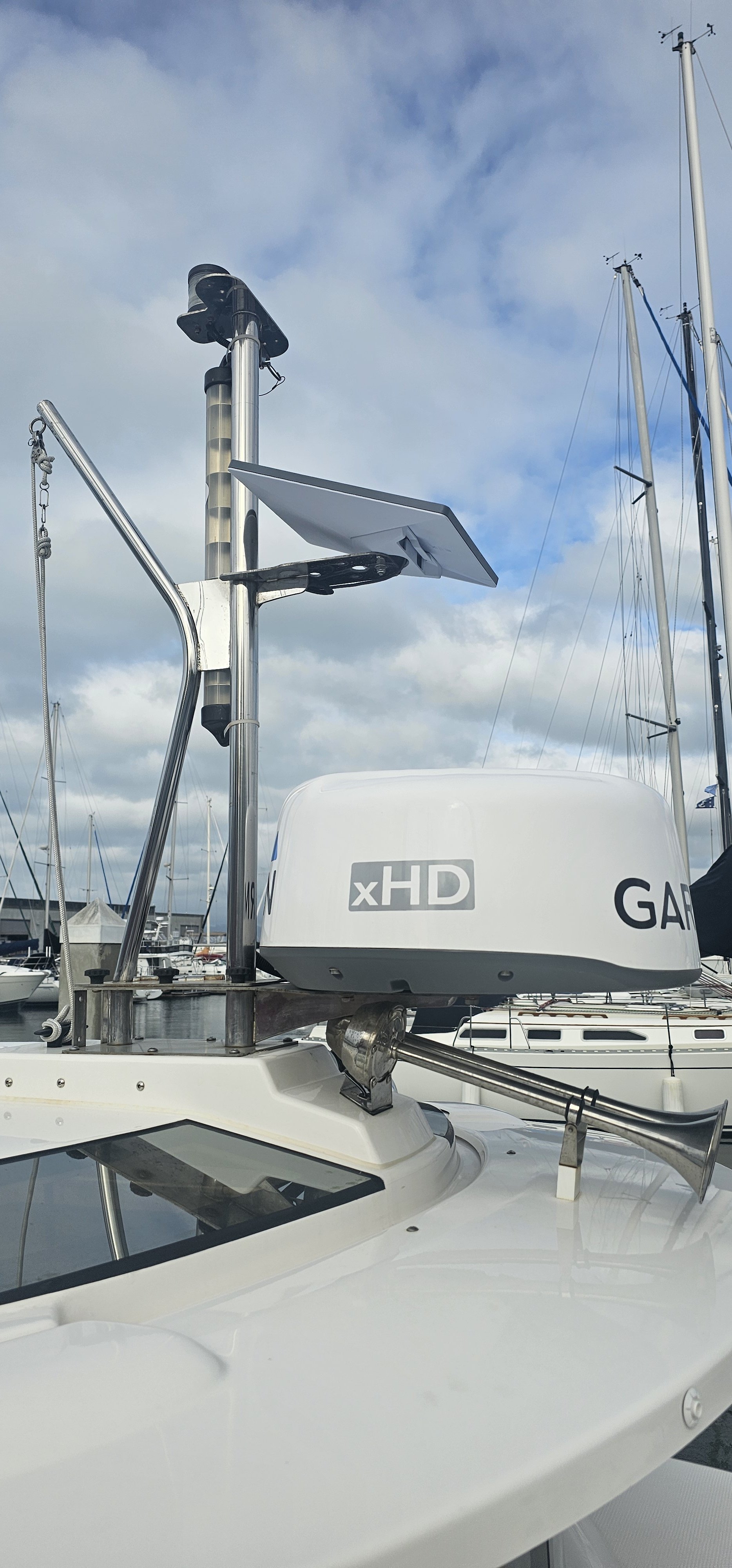

I used the Coax wire for the TV antenna to run 24VDC out to our Starlink unit. It is working great. I ended up crimping waterproof butt connectors on as I was unable to solder to the shielding braid of the Coax. If you can find a connector that might work better, just remember it all needs to be waterproof.
