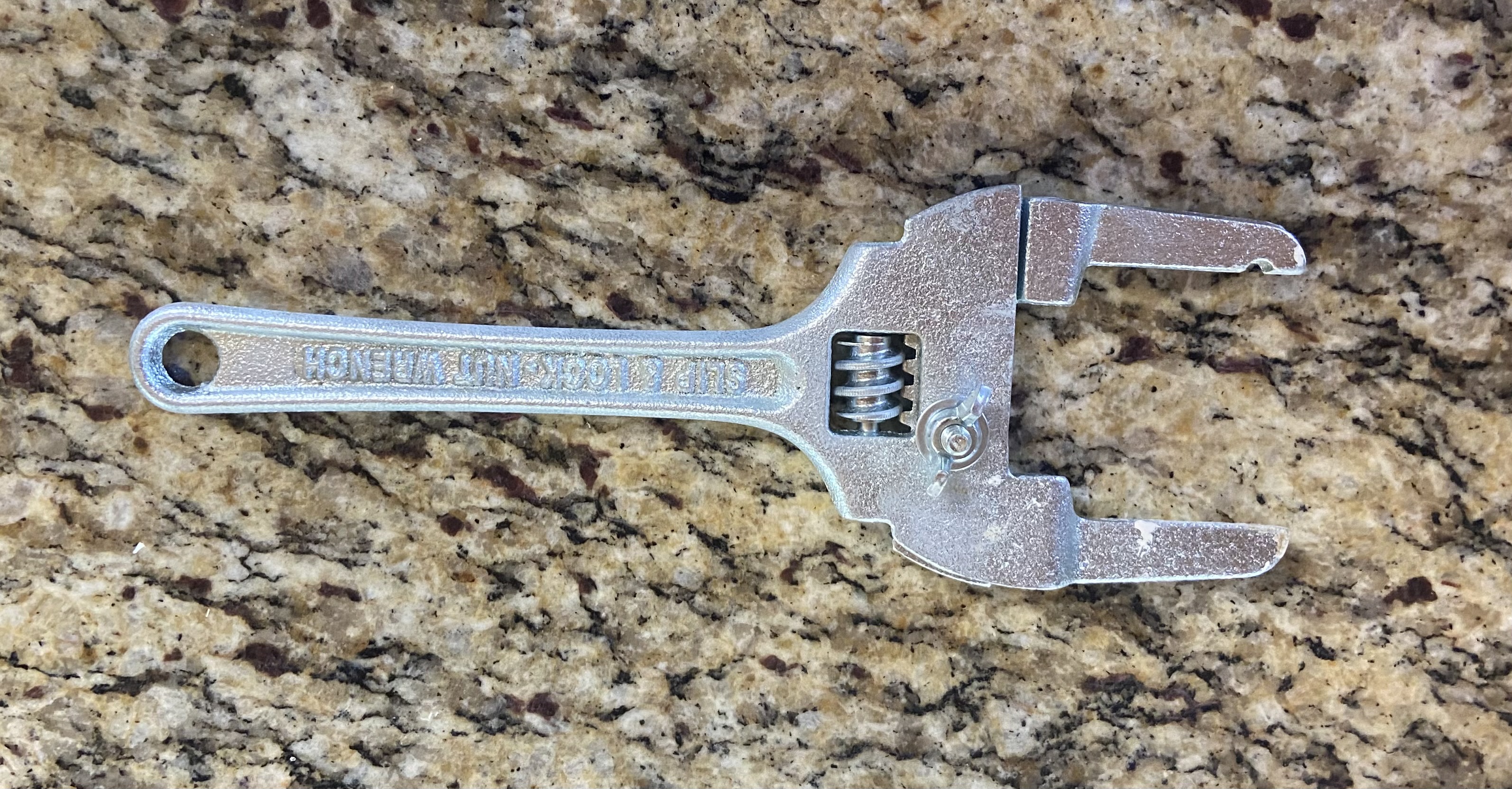

This is what I use, I think it’s called a slip & lock nut wrench sold at most hardware stores
Thanks to both of you. I suspect that I would need a 3/16" packing material because my stuffing box is smaller. WRT the wrench, I snagged one from my neighbour who sold his boat a few years back but kept the tools.
