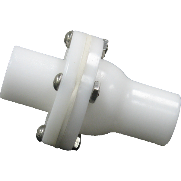

There should be a check valve in line for the head. There was one on our boat which uses the same strainer for wash down ,head and engine. I switched to fresh water flush so I removed the check valve and hose to the head and made the strainers extra fitting a flush port for the engine and a emergency bilge pump. I never liked having the head and engine using the same strainer. I also installed a shut off valve for the wash down to take that out of the equation for a air leak.
Air can not get past a ball valve unless it is damaged. We used ball valves on our air compressors 140 psi and experienced no leakage.
I would trust the ball valve before I would trust the check valve. Cutwater used the same check valve for the head has they used for the bilge pumps.
This is the check valve installed
