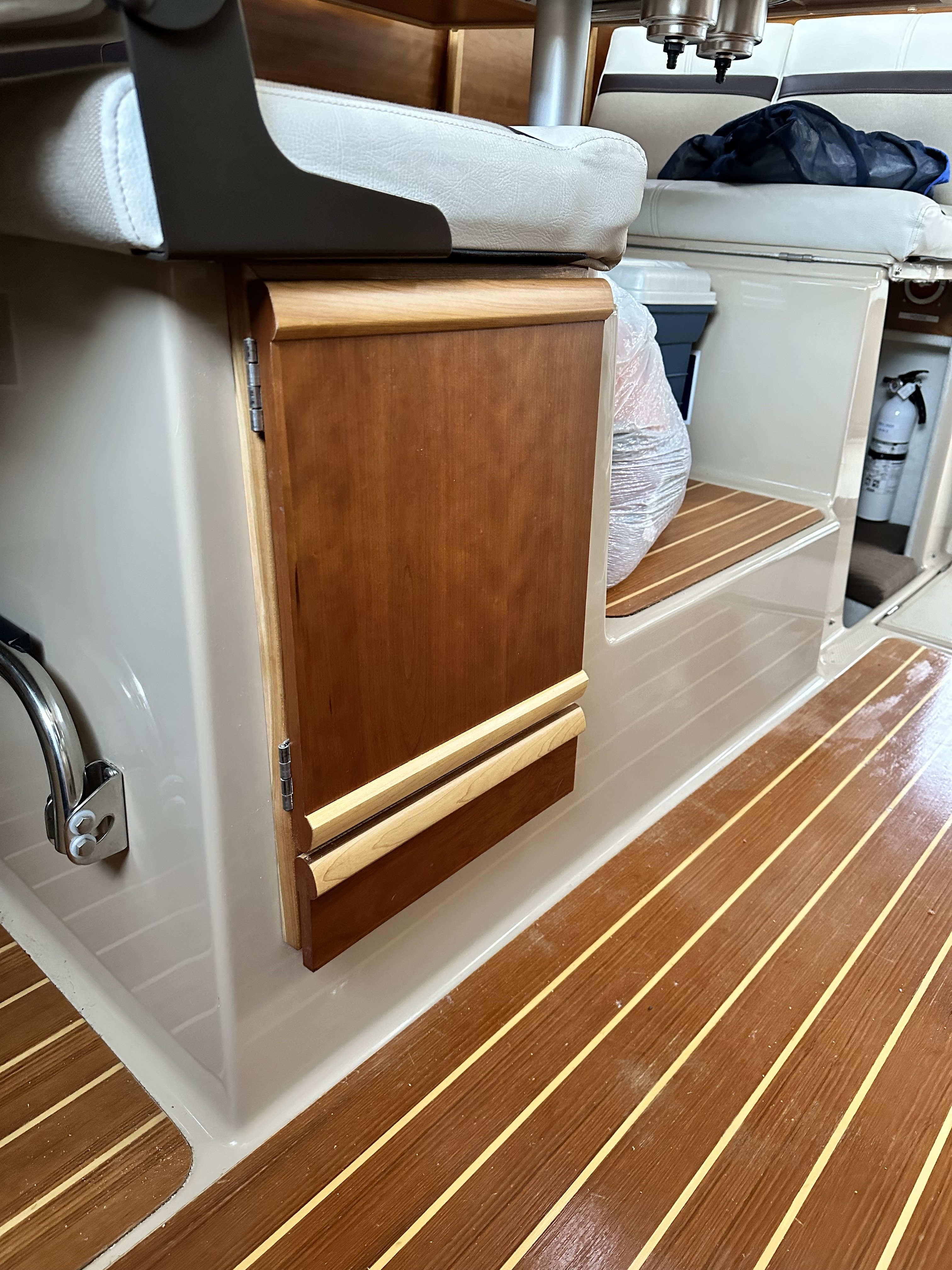

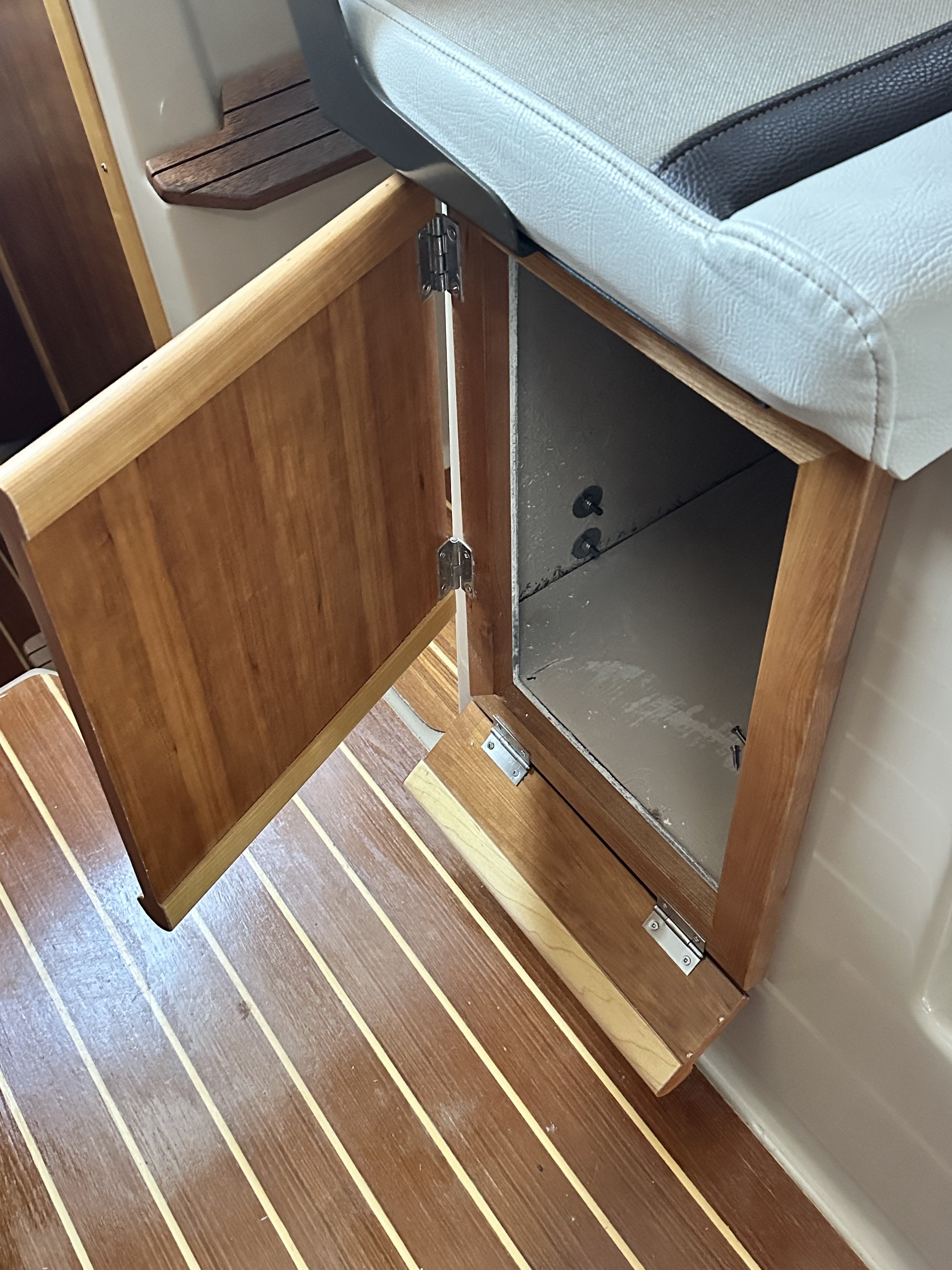

When removed, the available storage space created is quite large. We now store all dry goods in that space. The Admiral highly approved of the conversion.
We kept the wine cooler and could reinstall it if a new owner preferred to have it.
I’m happy with the look of the new doors I fabricated for the space.

We’re not wine drinkers and wanted more space for general storage. Its a pretty big space.
It is a perfect dry space to store tool bags, making them readily accessible when needed.
