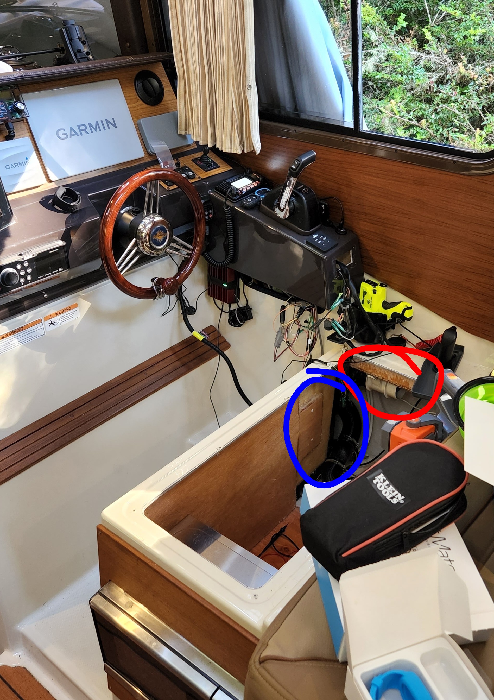

On our '21 R27OB, the defog fan is mounted under the helm seat (it's actually a Rule bilge blower). It's ducted to the two vents on the helm panel and dash. You can access the fan by removing the helm seat or the microwave. Removing the helm seat will be better access but tends to be a bit more involved.
Red circle is the fan after I moved it. Blue circle is where it was from the factory.

Here's a photo of the fan.
It's the white round fan in this photo.
