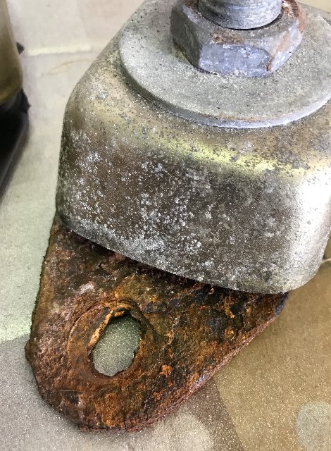

I recently had the engine mounts replaced on my 4BY2-180 powered 2012 R27. I had this done because the feet of the engine mounts that attach them to the stringers were corroding badly, especially the rear mounts and on the port side in particular. This corrosion resulted from poorly designed drains that discharge into the engine compartment that kept the mount feet constantly wet.

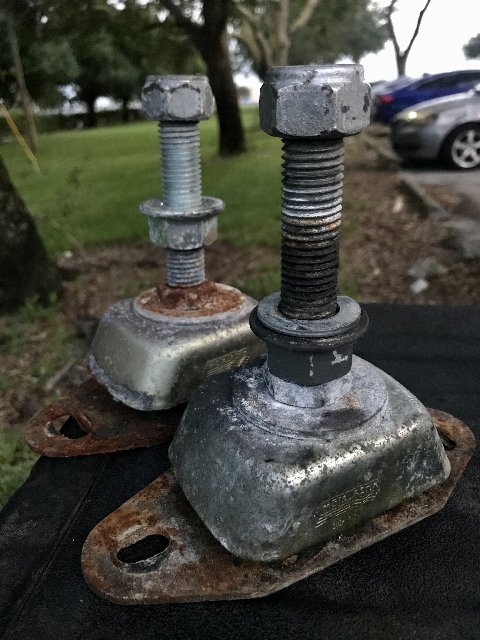

When I delivered the boat to the technician’s shop, after spending about 90 seconds looking over the mounts, the technician discovered that the port forward mount was not holding the engine at all. Not one bit. Zero. Zilch. Nada. The engine was merely floating up and down the bolt that was supposed to be securing the engine to the stringer.
Apparently, it was that way when the boat left the factory. The lower nut on the engine mount bolt acts as a jam nut for the upper nut that secures the engine to the mount. The lower nut was was all the way to the bottom of the bolt and jammed there. There were no witness marks that indicated that it had ever acted as a jam nut.

This is the corroded foot of the port rear engine mount. To my surprise, the foot still had a fair amount of strength, but I’m glad I changed it.

The mount in the foreground is the port forward mount that was not functioning as a mount. The jam nut can be seen all the way to the bottom of the bolt. The starboard right engine mount is in the background with the jam nut where it should be.
