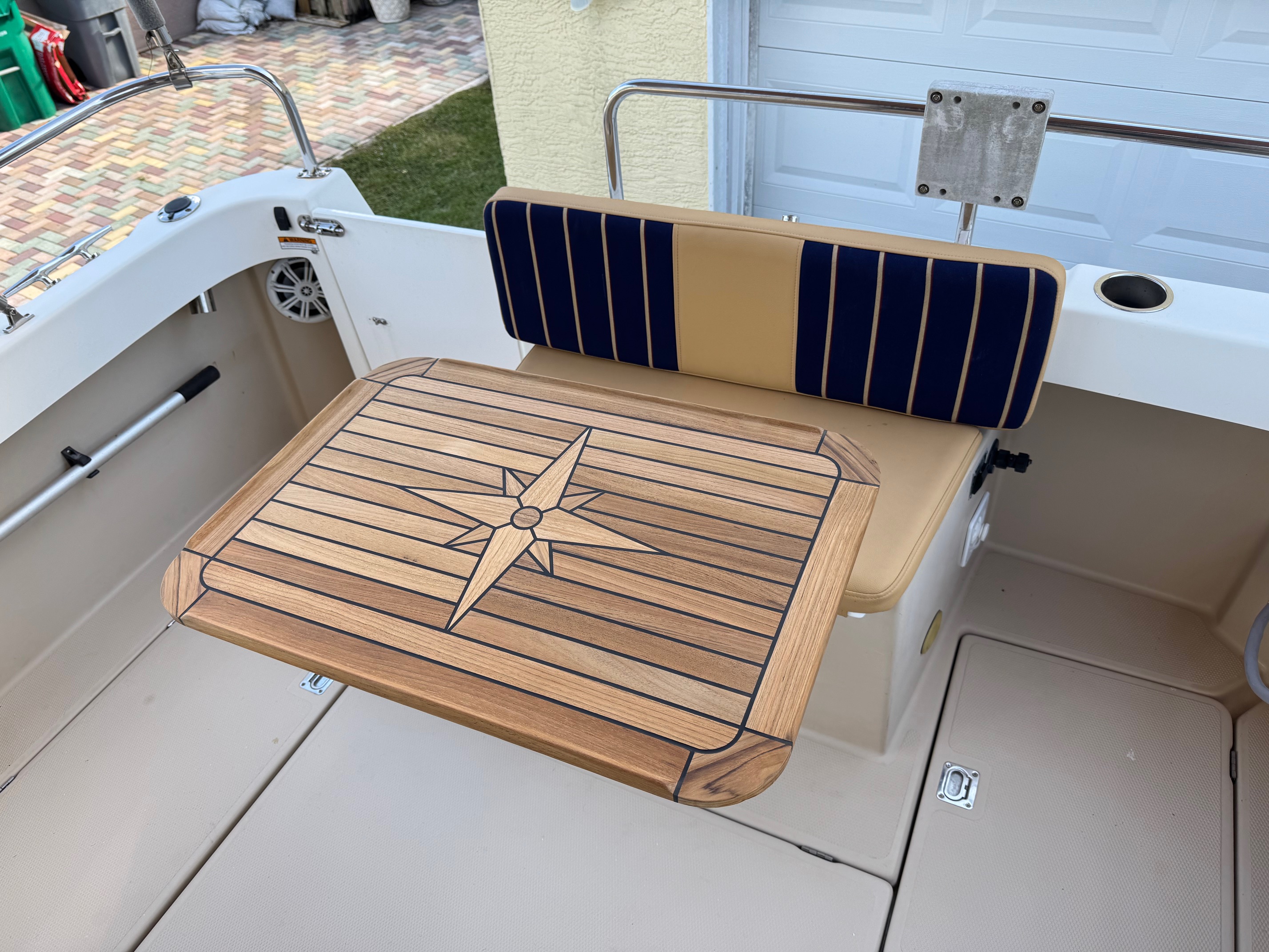

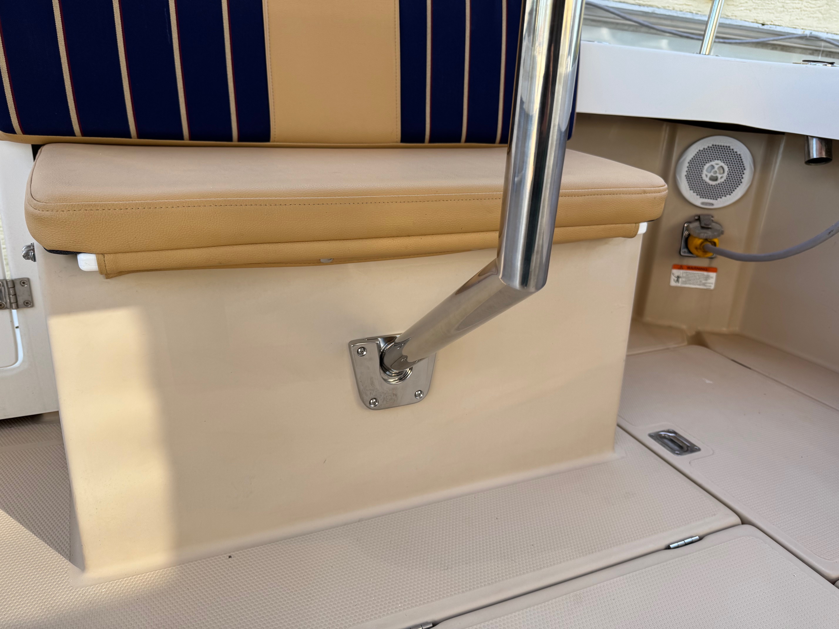

Because I was 'in the same boat' as the original poster to this thread and wanted to add a cockpit table similar to the stock one on later models, I thought I'd update with our solution. Unlike the later, later models with a floor mount pedestal we stuck with the side mount option. We got the Taco marine mount and brackets like the stock table, and ordered the teak table itself from an Australian company with surprisingly fast shipping to Florida. Parts and photo below.
https://www.amazon.com/dp/B01G4AINZI?ref=fed_asin_title (angle bracket)
https://www.amazon.com/dp/B01G40KTMI?ref=fed_asin_title (table base with locking mechanism)
https://www.amazon.com/dp/B07Z8FQSY9?ref=fed_asin_title (side mount bracket)
https://www.amazon.com/dp/B07YMPBGJV?ref=fed_asin_title (side mount backing plate)
https://www.nauteakmarine.com/default/teak-tables/teak-table-top-rounded-corners/ (teak table)
