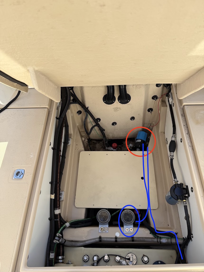

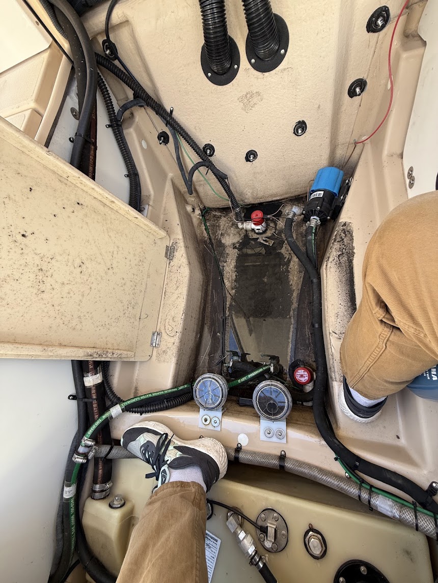

This pic is not my current boat but another identical that we used as reference. You can see the install location from factory.

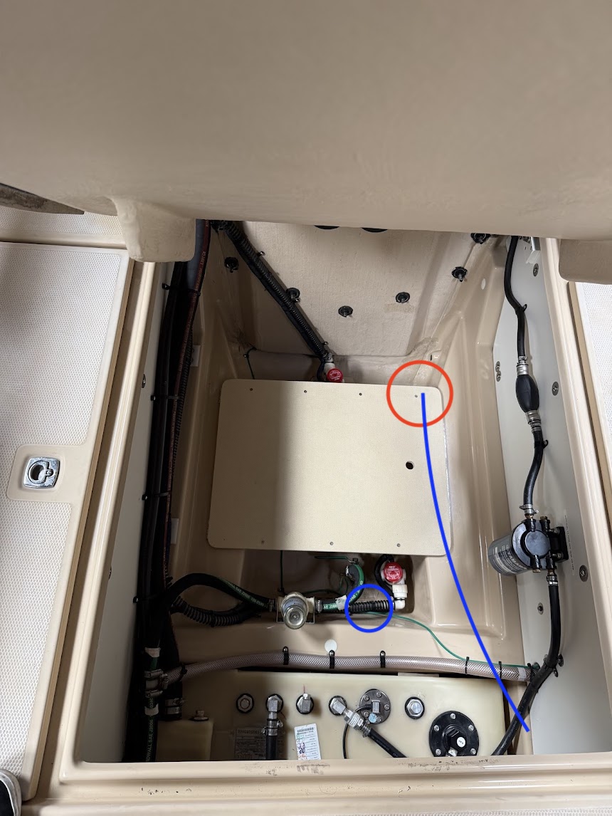

This is my boat before we installed. I will try and get pics this weekend after install.
here is a better pic of the reference boat (NOT MINE! this one was a mess lol) but yuou can see the location of everything. The starboard strainer is the other thru hole that you should already have for the toilet and other items on the boat. You can see the different parts used by the factory as this reference boat was a 2019 and mine is 2020 and they used different model strainers. Basically under the boat you will have 2 side by side thru holes.
We choose to do it this way since we have the boat out of the water anyway getting a seakeeper and a bunch of other upgrades. But I did have the thought to try and tap off the existing hole and it was highly suggested by everyone not to do that, even though I argued that how often am I running the toilet and the AC continiously.. But better to just match factory setup for both operation and future value of the boat.. We also opted for the better Blucool model over the webasto platinum that comes factory as it has the better touch screen controler and runs about 200w more efficient on power as we plan to be able to run on battery and motor for short periods.

First few pics are of the thruhull, pump and strainer setup. You can clearly see where we put it all. Basically factory location. Then for the AC that is the control box sitting in front of the fridge that we had to pull out to install the seakeeper but basically that and the AC unit will go under that front seat in the factory location. The last 2 pics are the seakeeper we did, put those in for fun! and the bad girl herself in the shop.
