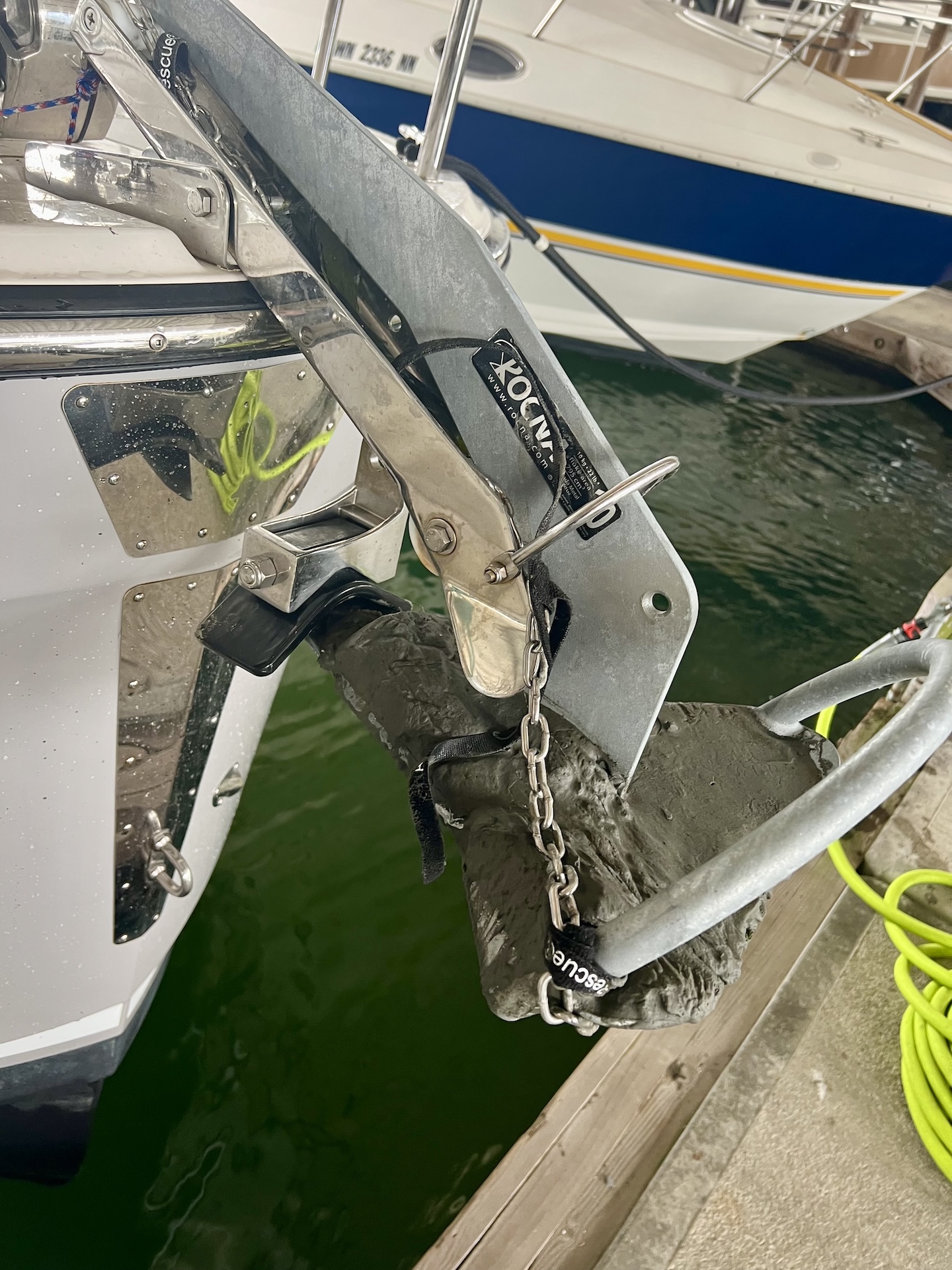

Few things. First these boats do swing some but probably swing a lot more white excess rode out. Even if you had 5 to 1 scope that puts you at 80 feet total chain and rode combined. Second is the stock Lewmar anchor is marginal. It should be replaced with a Rocna 10 or similar . Also an anchor bridle will also help the reduce the swing a bit and it keeps the rode from fraying when the boat is swinging.
