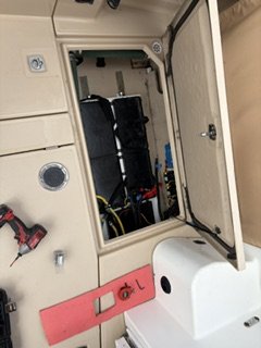

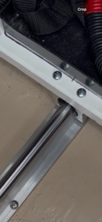

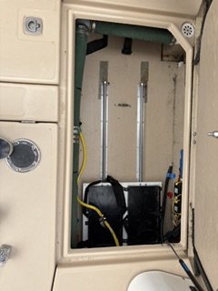

As I’m sure everyone is aware accessing batteries to disconnect for storage and or replacement is not the best. I came up with a solution that works amazingly. Just wanted to share with everyone as this forum has provided me with so much helpful info over the years. I used what’s called a linear slide rail and purchased 4 extra linear slide blocks mounting them on the board which the batteries are placed on allowing the batteries to slide out to be worked on without crawling into a confined space. Ordered 4 extra blocks per side mounted under the middle of where the batteries run as to give even weight distribution. Also ordered 4x linear stop collars to secure in place. Hope the pictures help understand this and the Links from Amazon below ….
