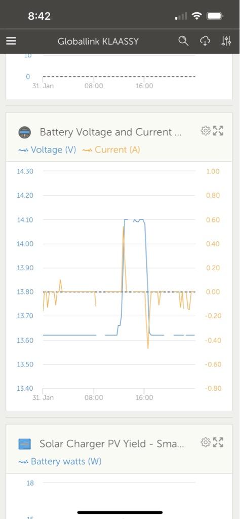

croakz":206m7t1x said:Reporting back on the Victron Globallink 520.
This thing is awesome.
I wired it's power harness to a battery, plugged it in, and it's on. Went to the Victron app, saw it listed (via bluetooth) and connected to it. It connected right away to T-Mobile, using the prepaid LTE-M (which is good for 5 years). Now the cool part, I connected it to my SmartShunt without using a VE.direct cable! It connects to it via bluetooth so I had no other cables to deal with. Looks like this is called "Instant Readout" by Victron. I'm hoping they add my Orion-Tr DCtoDC charger in the future.
https://www.victronenergy.com/media/pg/ ... o-vrm.html
Anyhow, I now can use Victron VRM to monitor my batteries and MPPT. Came out to $200 for 5 years, and then they say you can extend service, but I can't tell how much that'd cost. I'm pretty interested in learning how to use the digital inputs. Also, I got some Ruuvi sensors, looking forward to using those to keep track of temperature remotely.

I love this. Thanks for sharing something else I can spend money on! :lol:
I have been wanting a way to get all my victron data remotely without installing a cerbo GX and bunch of ve.direct cables. I also have a separate system by a brand called govee for monitoring temp/humidity in various areas of the boat. Cool that I can get the ruuvi sensors and have it all in one app, and not need a separate wifi-bridge for the govee that only plugs into AC power.
