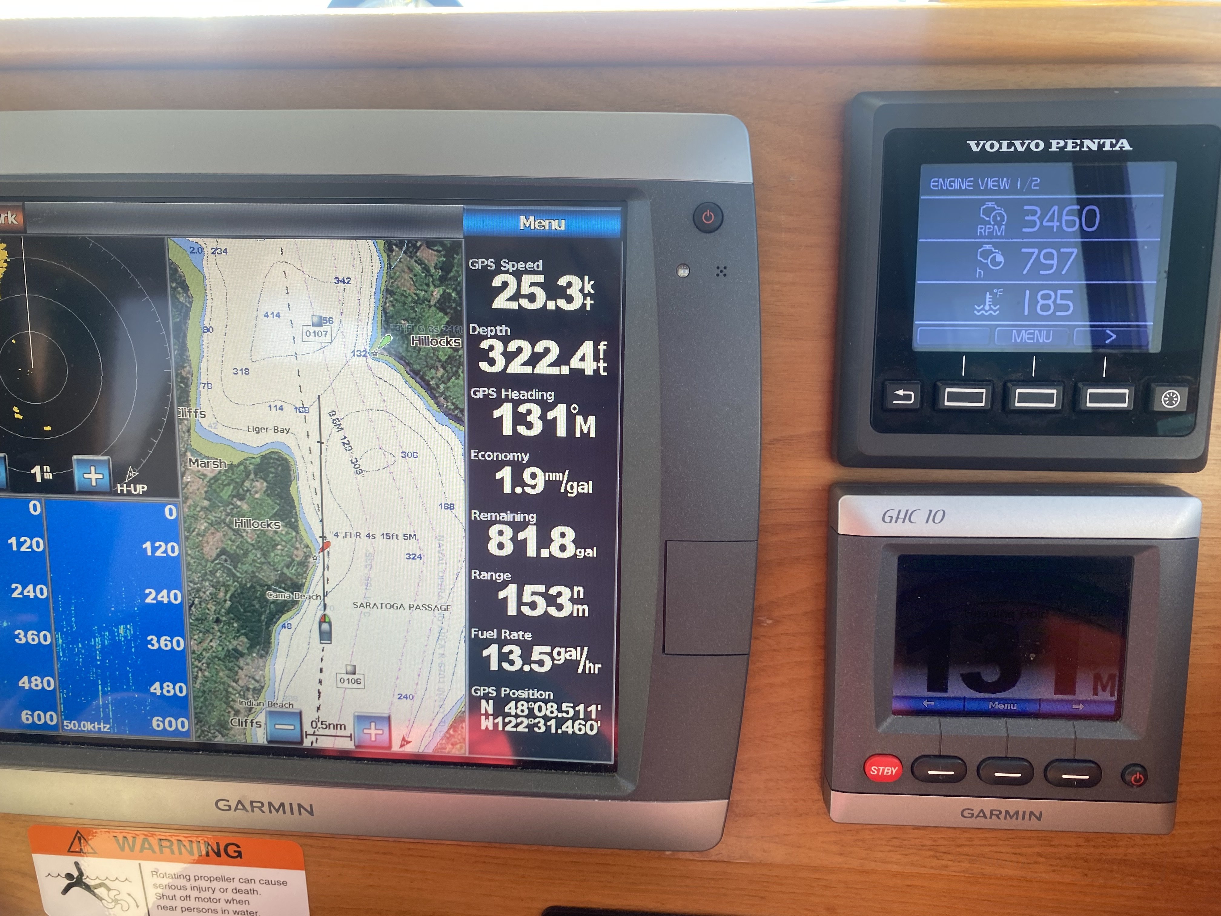

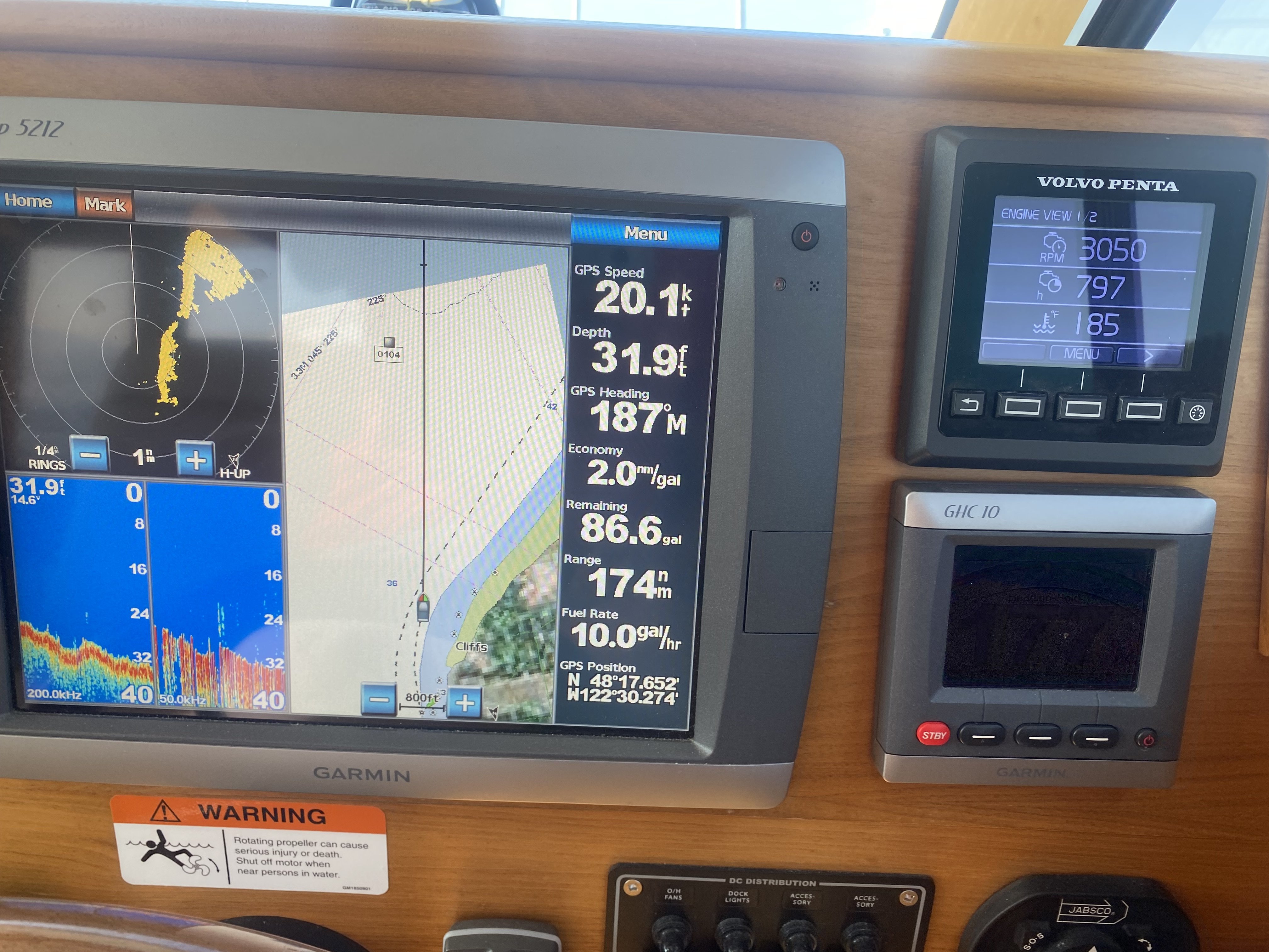

Was getting 1.5nmpg at cruise at 3090 rpm’s. Now getting close to 2.0 at 3050 rpm.
Almost 2 knots faster!
Max speed is up to 25knots

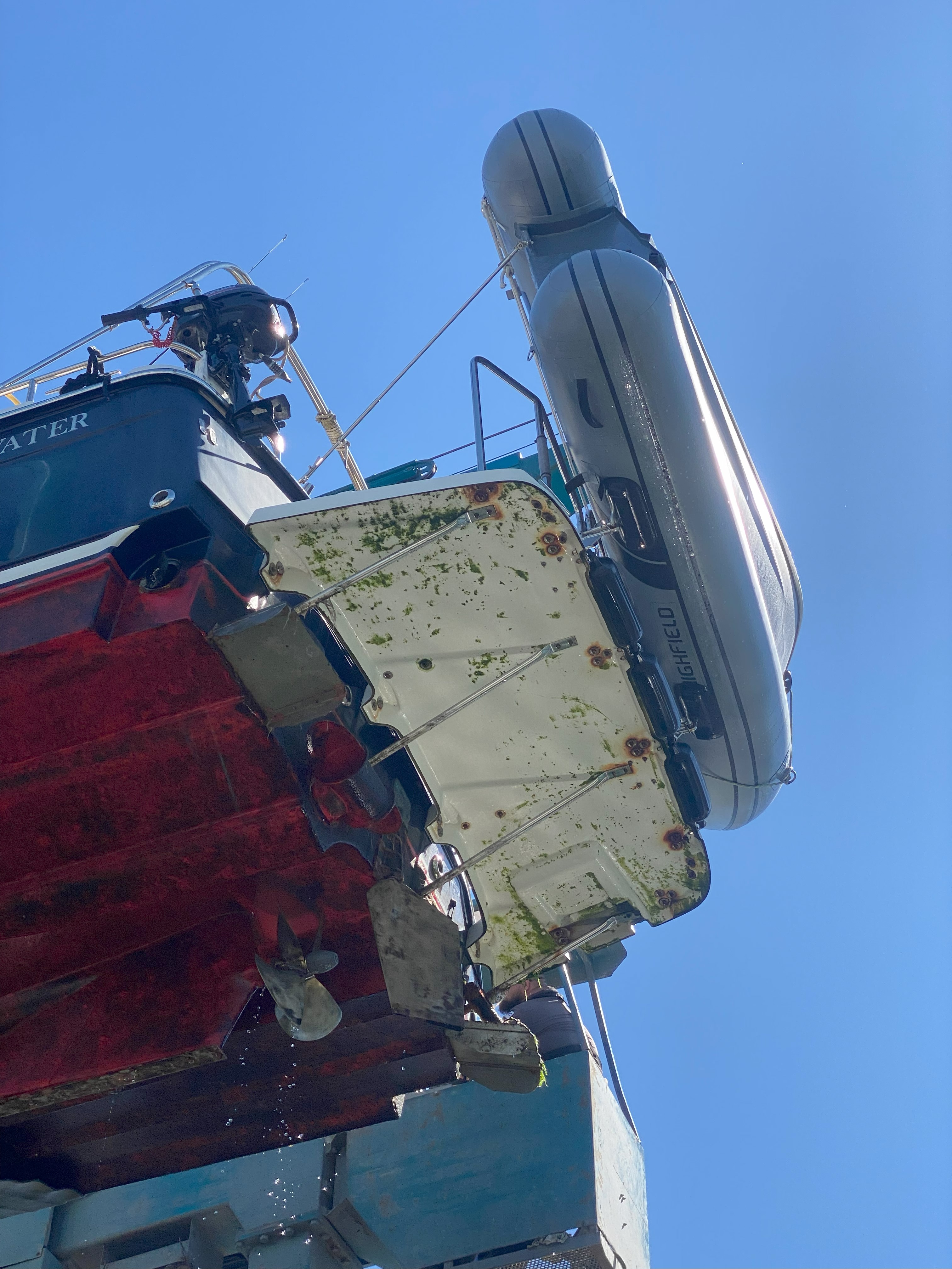

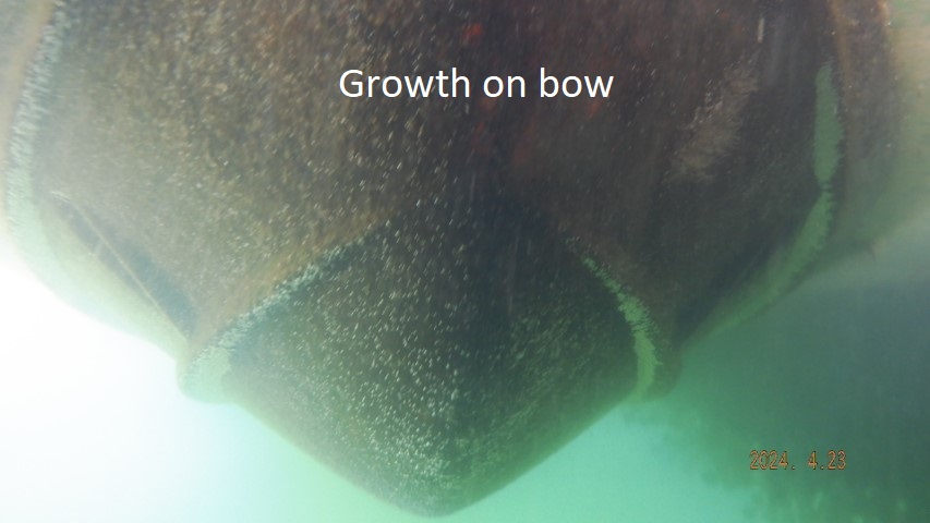

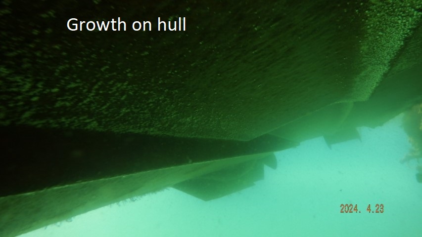

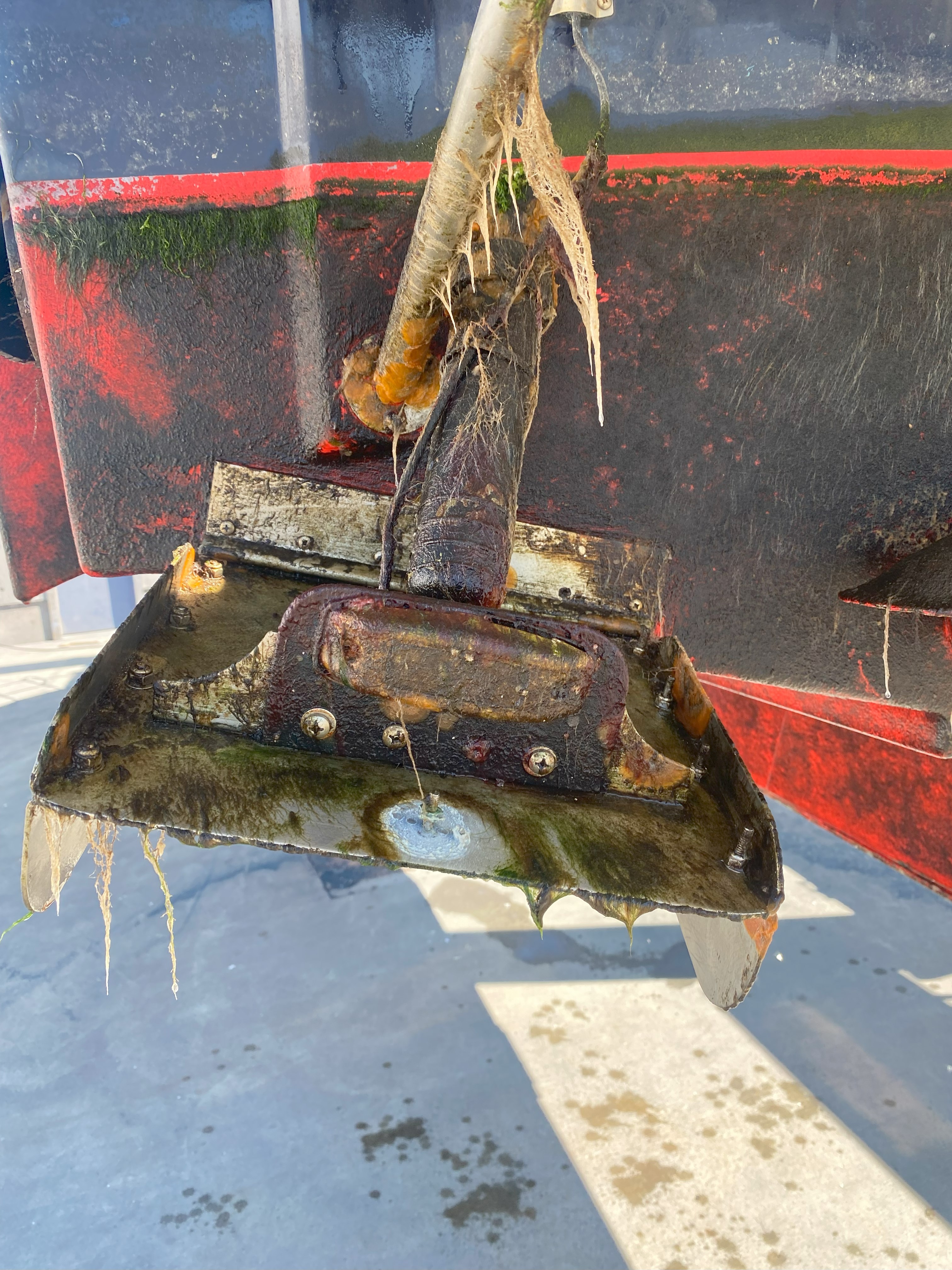

im not sure how to quantify. diver has been saying for a year its getting thin. there was short growth at the waterline. and the overall hull was dark from the growth but it wasn't long.
the diver could clean it and performance would stay the same. here are photos from the last dive and then the haul out
Clearly the diver clean was not the same impact...not blaming the diver...it is what it is. Very informative post. Glad I keep my boat on a lift!
