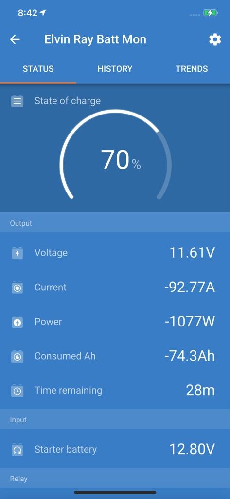

The A/C pulls about 90 amps. Best thing would be to buy a suitcase generator (we have a Honda 2200) and you can run A/C or cooktop or water heater, etc….

4. Run my AC only when the engine is running or on shore power. Usually, will get the cabin cooled off on shore power and then run it for 20 min increments en-route if it gets real hot.
5. I installed solar myself. It was fairly easy and their is enough expertise on this forum to keep you straight. I installed a 210w panel and victron 100/30 MPPT with Smartshunt and battery sense's. Monitor everything from my phone or Ipad to get an idea of what's going on with my batteries and power consumption. Would be lost without the shunt, battery voltage isn't a true indicator of battery status.
