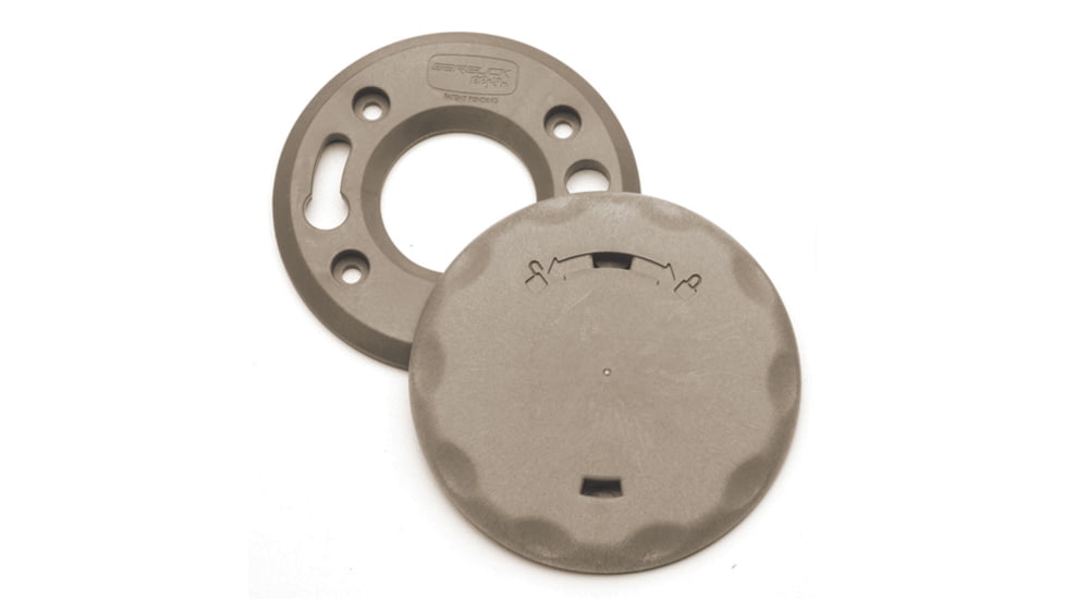

I used 1/4 screws to fasten to the cockpit sole sealing the holes with Boat Life sealant. The floor base has a cover for it when not using the table. I found a tan cover that came close to matching the gel color of the 2016 Cutwater cockpit https://op1.0ps.us/978-550-ffffff-no-up ... 1-main.jpg
