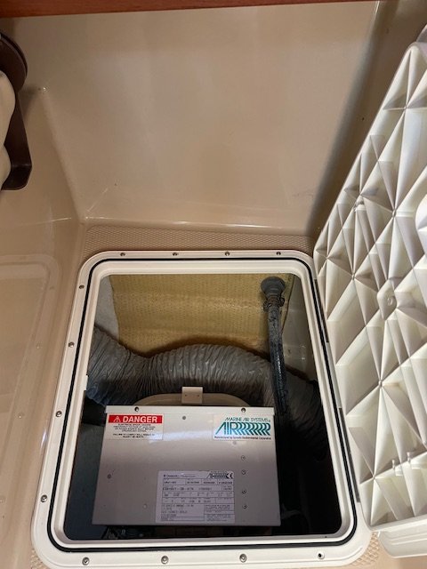

Finished deck cutout over AC unit. Deck in front of passenger seat cutout and hatch installed.
Sweet! Very well done! Will install mine next week when hatch arrives!
The deck is 1 inch honeycomb, sandwiched between a 1/4 inch (top) and 1/16 inch (bottom) layer of fiberglass, total thickness 1 5/16th inch. I covered the AC unit with a towel (fun adventure in the cave) and cutout the deck using a jigsaw with a metal cutting blade. A laminate cutting blade would work as long as it's long enough to extend through the deck on the upstroke. The two corners outboard had to be cut using a hole saw because the jigsaw couldn't make the turn for the rounded corners. Other than having the blade wander a bit once it was hot, the cut went pretty easy. The forward and seat bulkheads made a decent guide for the long side cuts. The saw table rode right against the bulkhead.
Fantastic info & detail…Very helpful indeed! Thank you!
