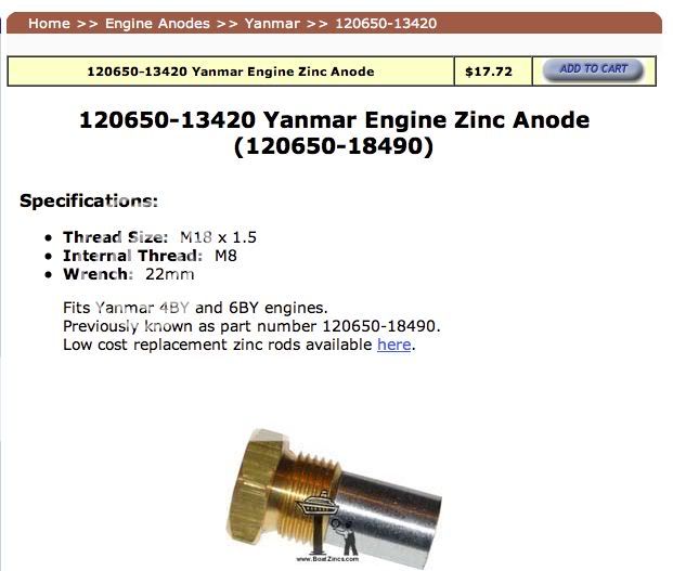

Every year you need to change the engine zincs (I've posted elsewhere on this on TugNuts). I had the kid do this as it's a two minute job and that was bundled into my $300 fee. However, I was charged $50 per zinc (Oh, joy!) for just the part:
Even with Canadian duty, how much can this $17 part cost you? I bought it on Boatzincs.com and there are likely comparable Canadian places. Its a bit more, but still way less than $50 to buy it from Ranger. BTW, you need two of them. You can actually just buy the zinc part for about $7 and screw it into the cap when the old zinc disappears.
