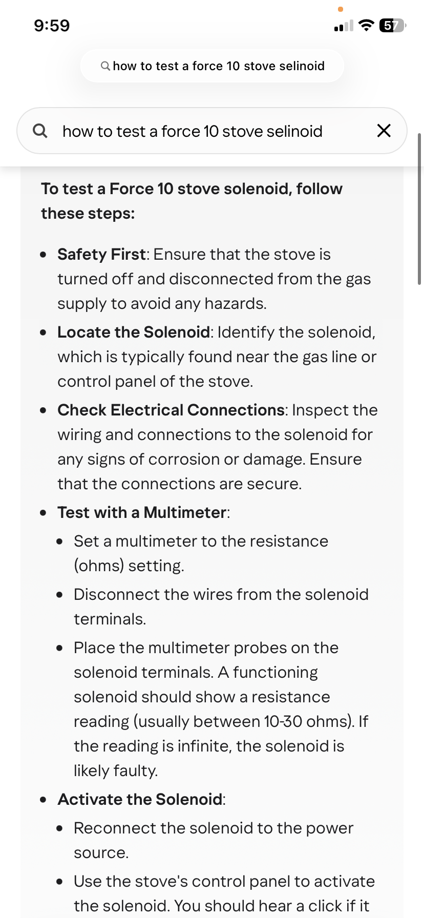

If you had to replace the solenoid on your force 10 stove line did you need to cut the wires on the existing solenoid and splice in the new one? Is there any way to check the solenoid without cutting the wires?
Thanks
hope this helps answer your question Bob
Thanks, how do you disconnect the wires?
