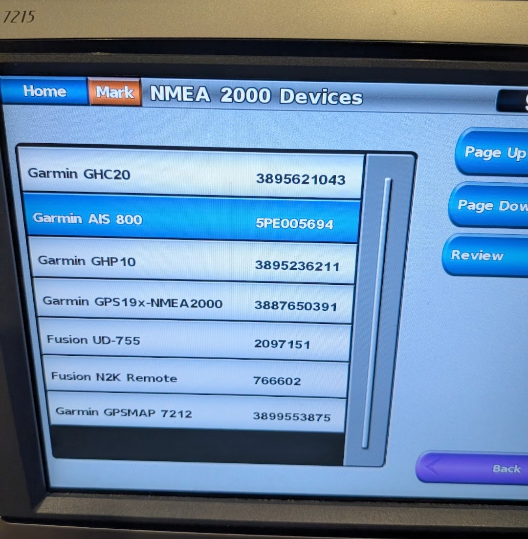

I installed an AIS800 plug n play into a 2017 R29. My boat has VHF 200 radio and Garmin 7612. Did not have to find backbone. Used existing wire from backbone. Correct connectors are supplied with AIS800. Needed a right angle drill to mount AIS800 since hole pattern difference. I bought cheapest ais800 I found on internet, only $800, free shipping and maybe no tax. It was hell dealing with them to get the MMSI programmed. It was NVN marine. I don't see the ais800 on their web site. I had to call Garmin after hookup to get my purple gps path to show. It was just an option in plotter to change.

I had an AIS 800 installed in my 2012 R27 last November. It worked fine with my Garmin 5212 when installed. The boat was stored indoors until a few weeks ago when I moved it on its trailer to an outdoor boat storage yard and ramp just off the Ohio River. So far, it has displayed AIS targets on the river as far as seven miles away.
Tomorrow, I plan to put the boat in the water and cruise it 10 miles upriver to my marina slip. I’ll post how it works.
