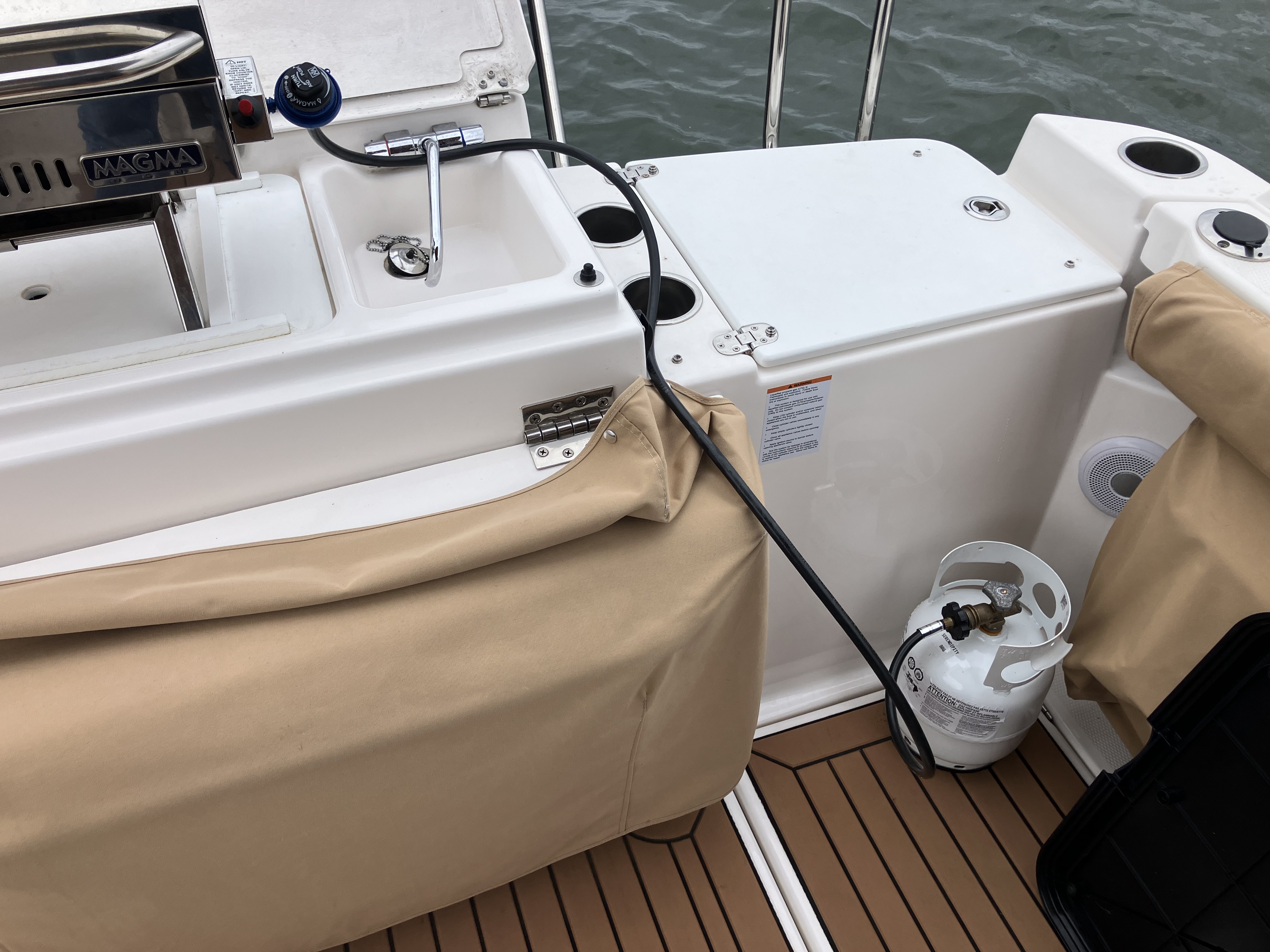

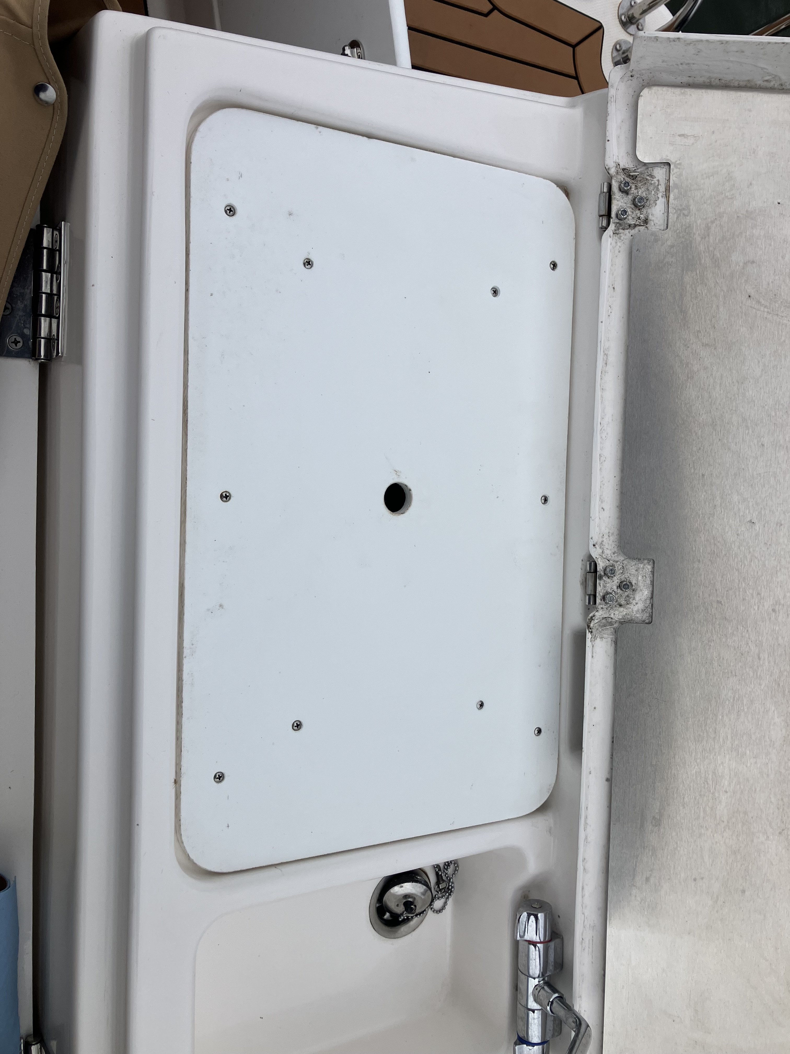

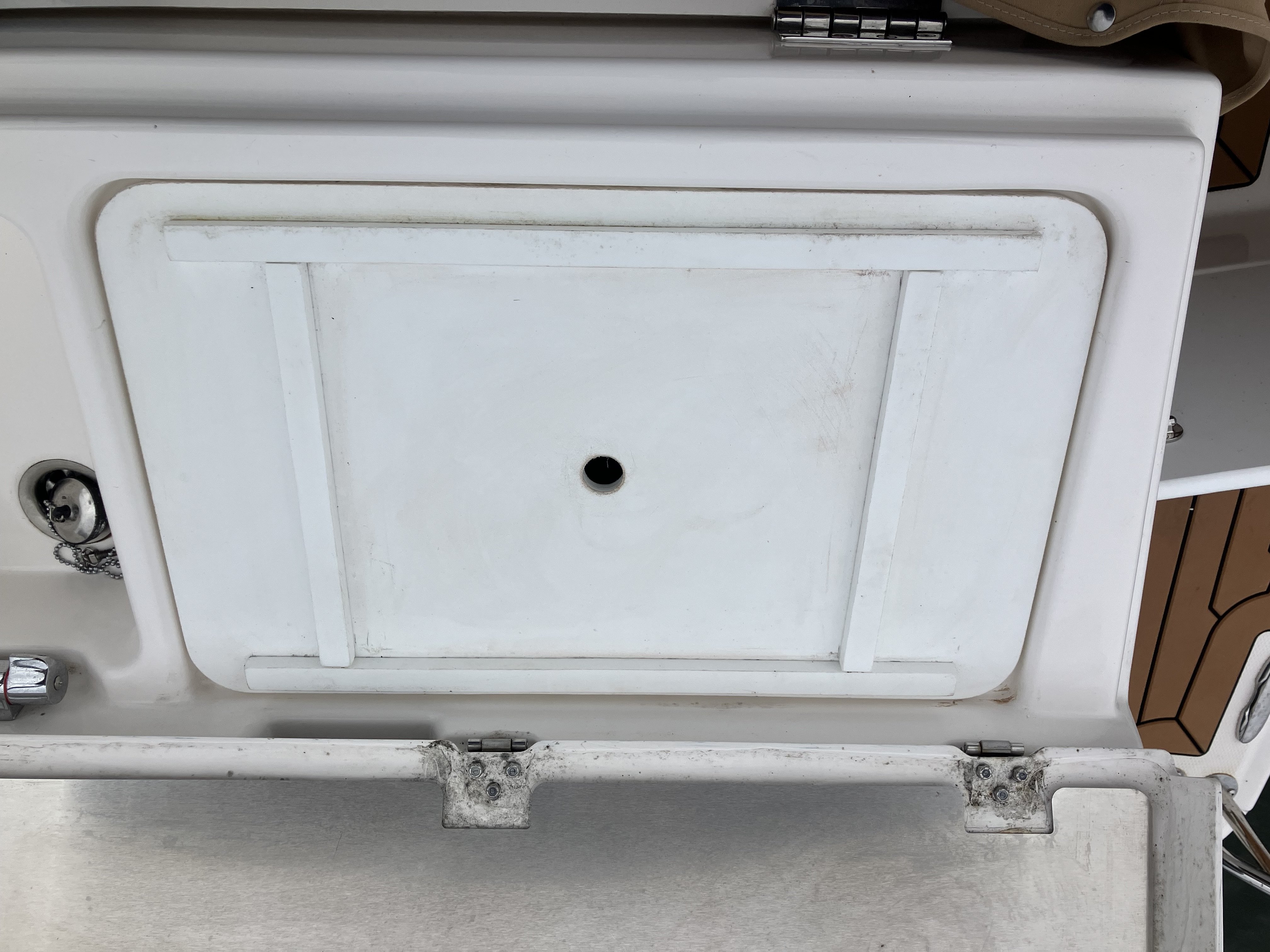

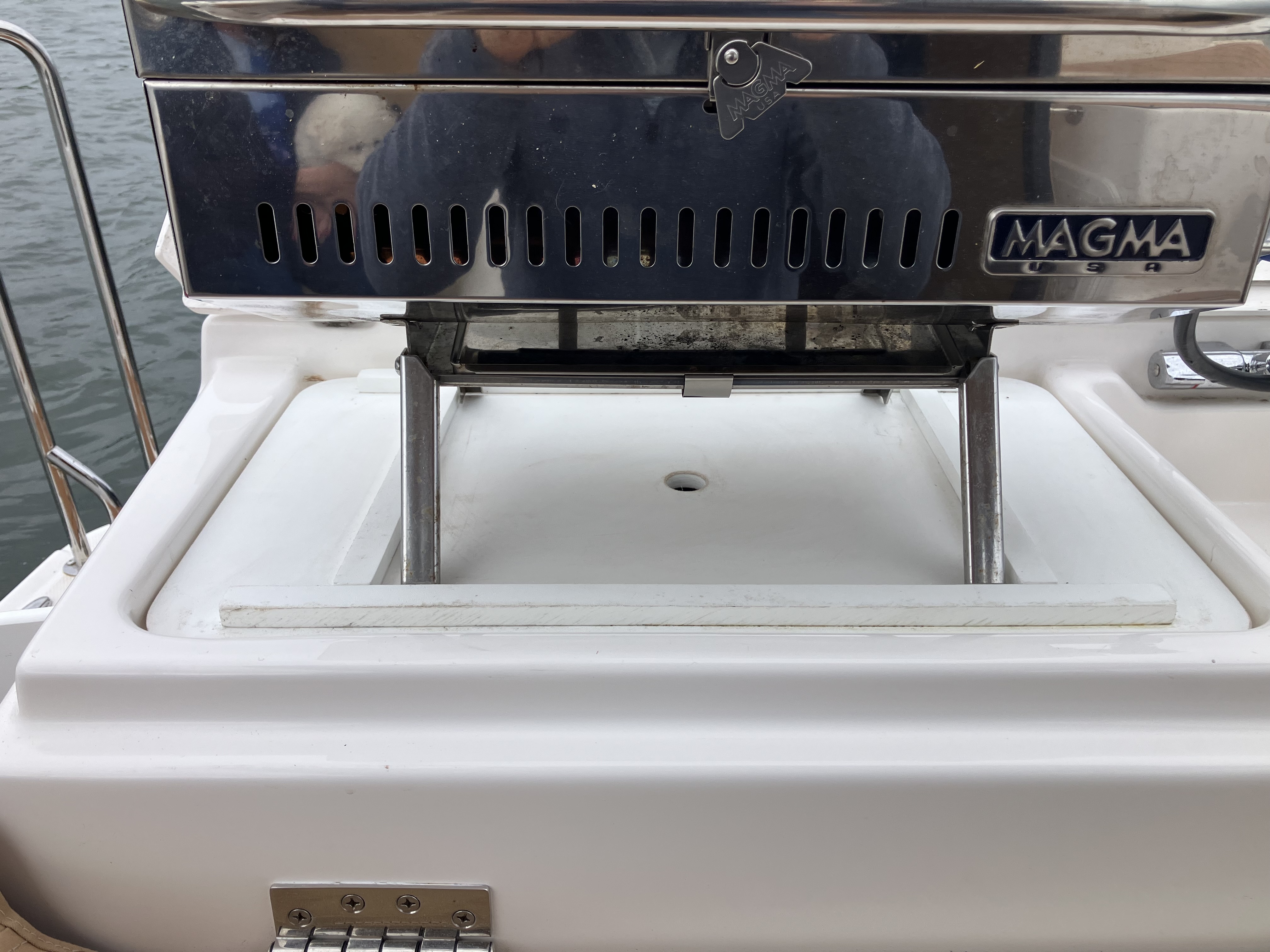

On our 2023 R27 we made a Starboard insert that replaces the Kenyon electric grill. We put a Magma grill on the insert and use a separate propane tank.
The baitwell is used as a trash lazerette. Both Kenyon and Magma grills are stored in the center cockpit locker. The spare tank goes in propane locker.
I put retaining strips on one side of the Starboard insert to support the panel when flipped over as a cover. The strips keep the legs of the Magma from sliding.

I will be down on the boat next week and will take some photos. We have a Magma Catalina classic grill. The grill’s foldout legs fit within fiddles on the Starboard insert. Anyway, “film ar eleven”, as they say!
Finally got to the boat to take pics of the grill insert on our 2023 R27 OB. The insert and fiddles were made from 1/2 inch Starboard.
View attachment 25442View attachment 25443View attachment 25444View attachment 25445
Thank you very much for the advice and effort. I purchased the same grill, and had a similar starboard insert made. However, I still need to fabricate the fiddles. The photos are very helpful. First week with the boat so lots on the to-do list. Thx again.
