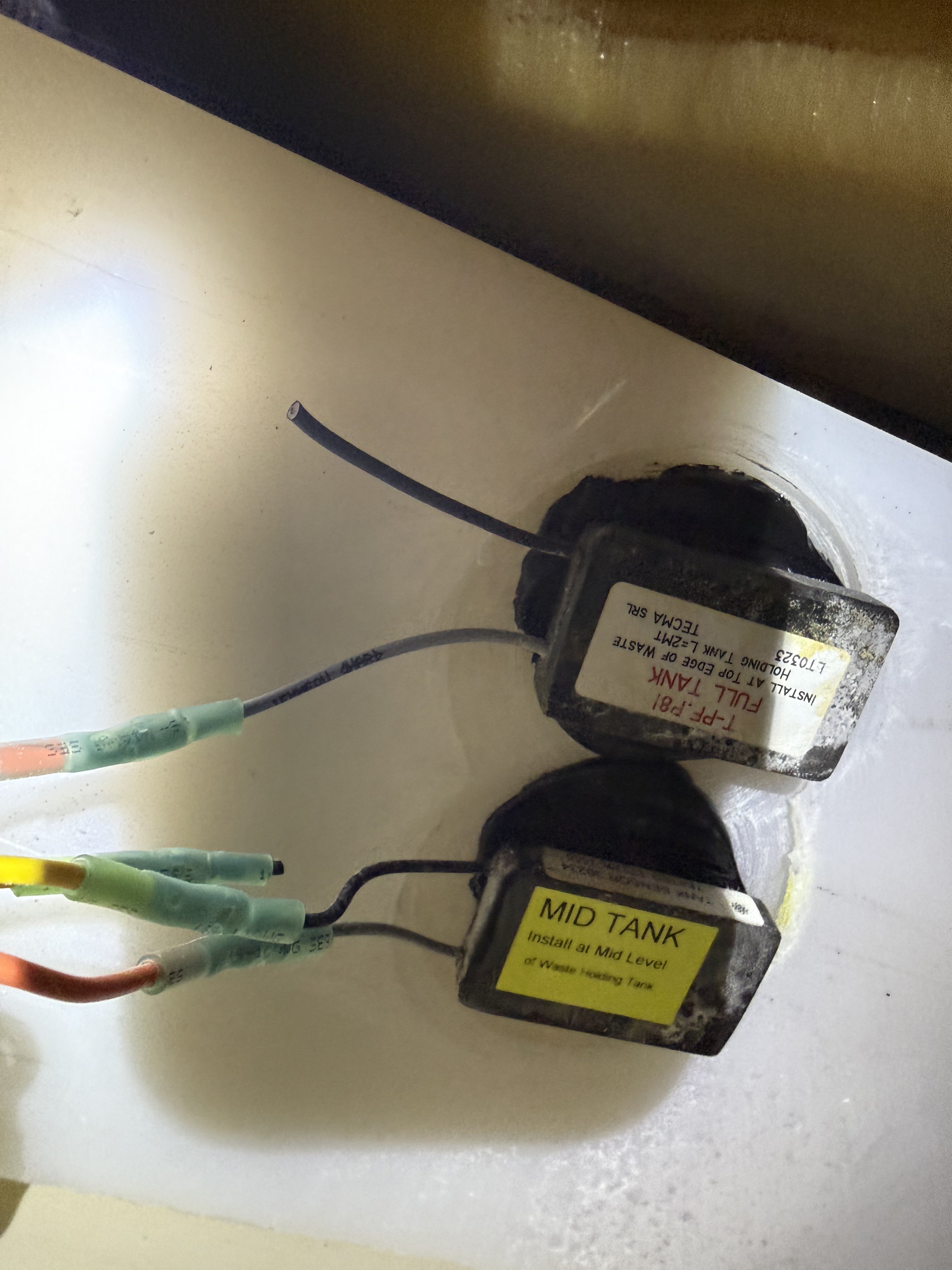

I have a 2025 R31. The holding tank gauge always shows red, which will not allow the toilet to be flushed. I have repeatedly filled and pumped out the tank. I always use Zaal Noflex Digester.

If your tank has the "stick on" sensors, you might check to see if the full tank sensor has been dislodged and is now lying down low against the tank or another surface causing it to stay in a constant "active, full" state.

Thanks, already checked that. While there I discovered the shower pump out hose had fallen off. Luckily I fixed it before my next shower.

I've replaced the sensors, but that didn't help.

Happened to us, sensor routinely showed red regardless of the actual level in the tank. Temporary solution was to disconnect the top sensor. Factory sent a different gauge that was installed into the top of the tank, with a status gauge installed above the toilet. We are happy with the new gauge - gives a much more accurate view of level in the tank.

One snip, and I have a toilet that flushes. Now, time for Ranger Tug to fix it under warranty.
