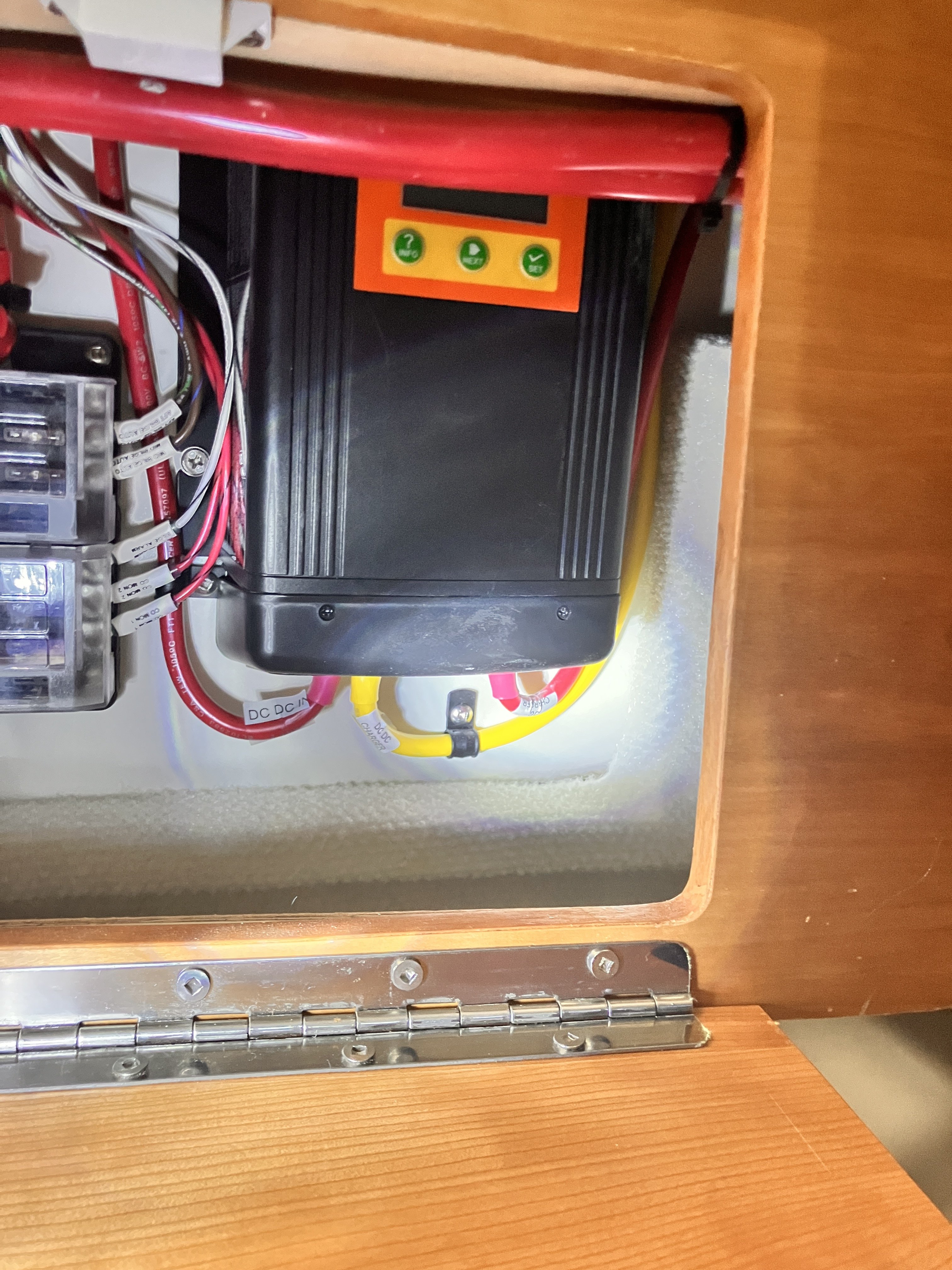

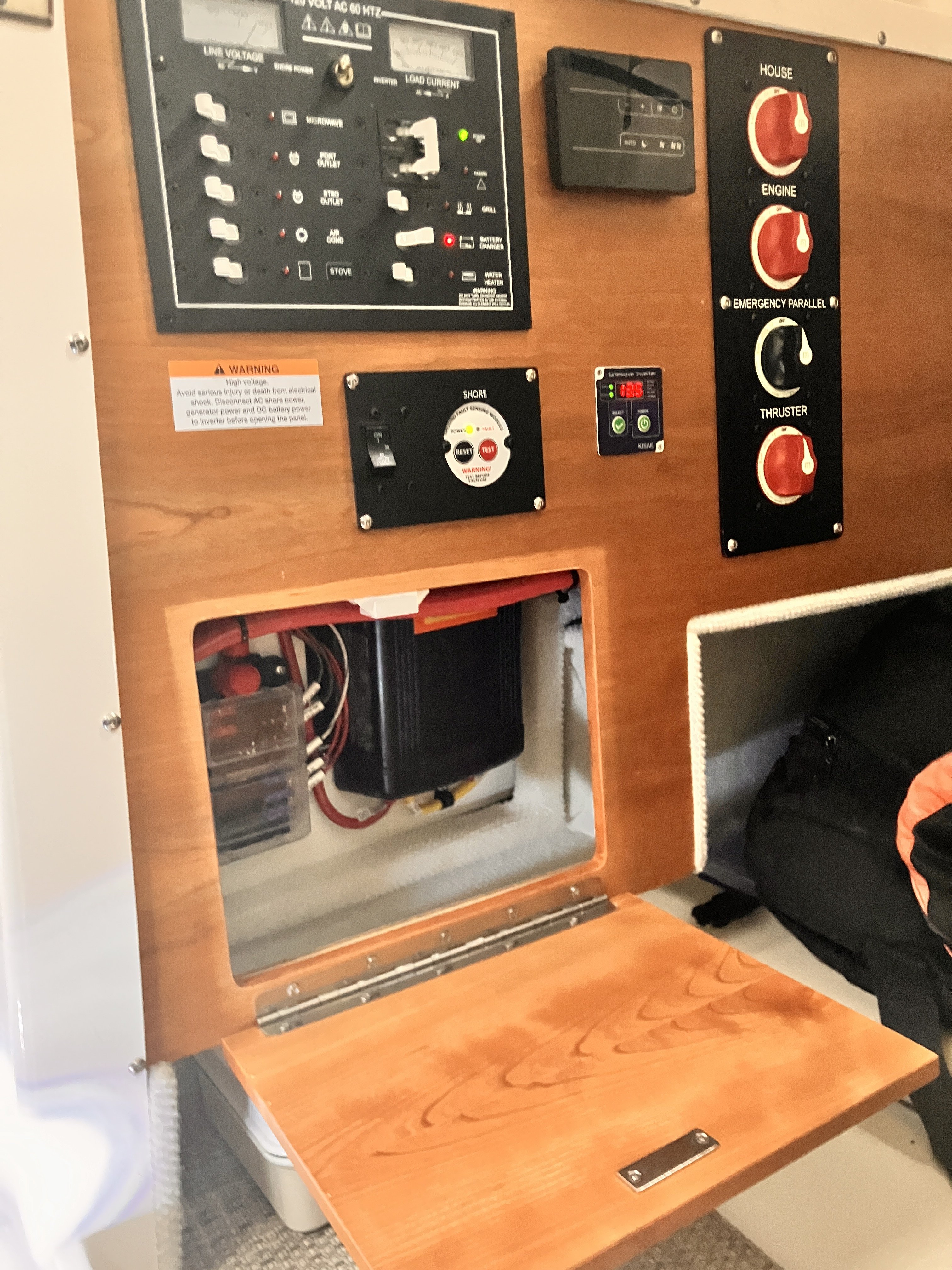

Is this the DC-DC converter? This image is from the quarter-berth.
Thanks again for your help in this and my other post on charging. The community here is really nice.
Yours in a different location than our 310. But it should be the one you are looking for. Remove the bottom two little Philips screws and you should see where you can connect the solar panel.
I hard wired to the converter and have a cord that I can pull out and connect to the panel when I need to charge batteries. Make sure to fuse the positive wire and use proper size wire.
