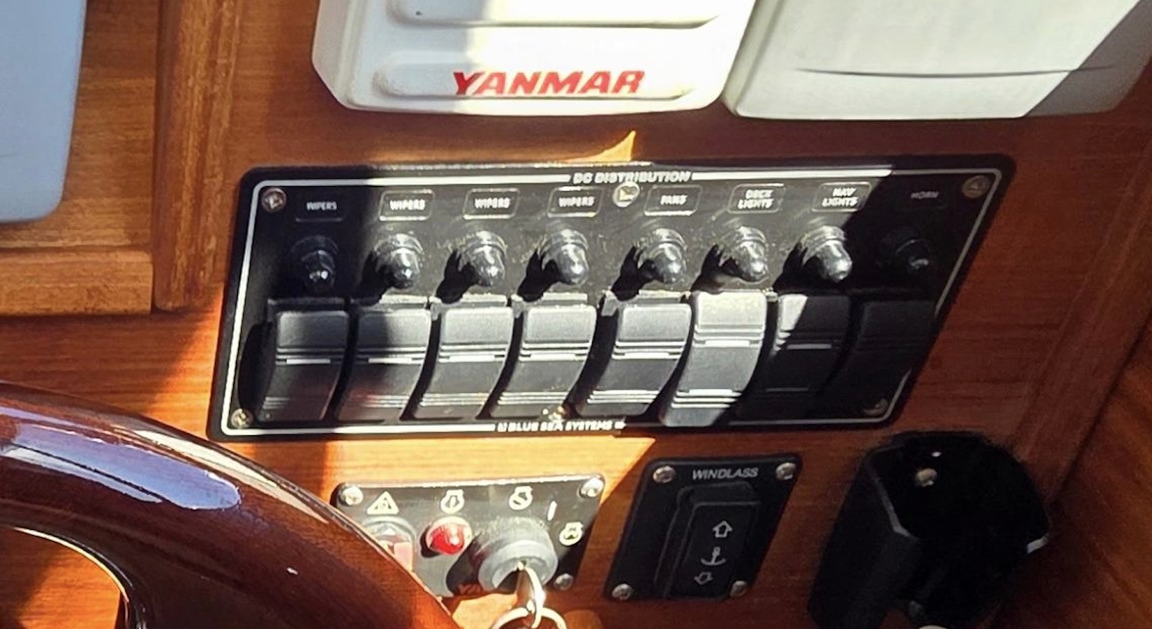

M Martin Active member Joined Sep 20, 2020 Messages 29 Fluid Motion Model C-28 Yesterday at 9:43 AM #1 I have a 2015 R27 and the horn and the deck lights are not working does any one know where the fuses are for the as I can not locate them,

HP41C New member Joined Oct 22, 2025 Messages 2 Location Michigan Fluid Motion Model R-27 Classic Non-Fluid Motion Model Pearson 323 Vessel Name Moriah Yesterday at 7:25 PM #2 2013 R27 here. Horn fuse is located above the horn switch. Mine is a recent acquisition and the horn did not work. Turns out the points needed cleaning and adjustment. See attached procedure for horn points cleaning. https://www.tugnuts.com/threads/ongarro-horn-repair.2227/ Chuck Moriah 2013 R-27
