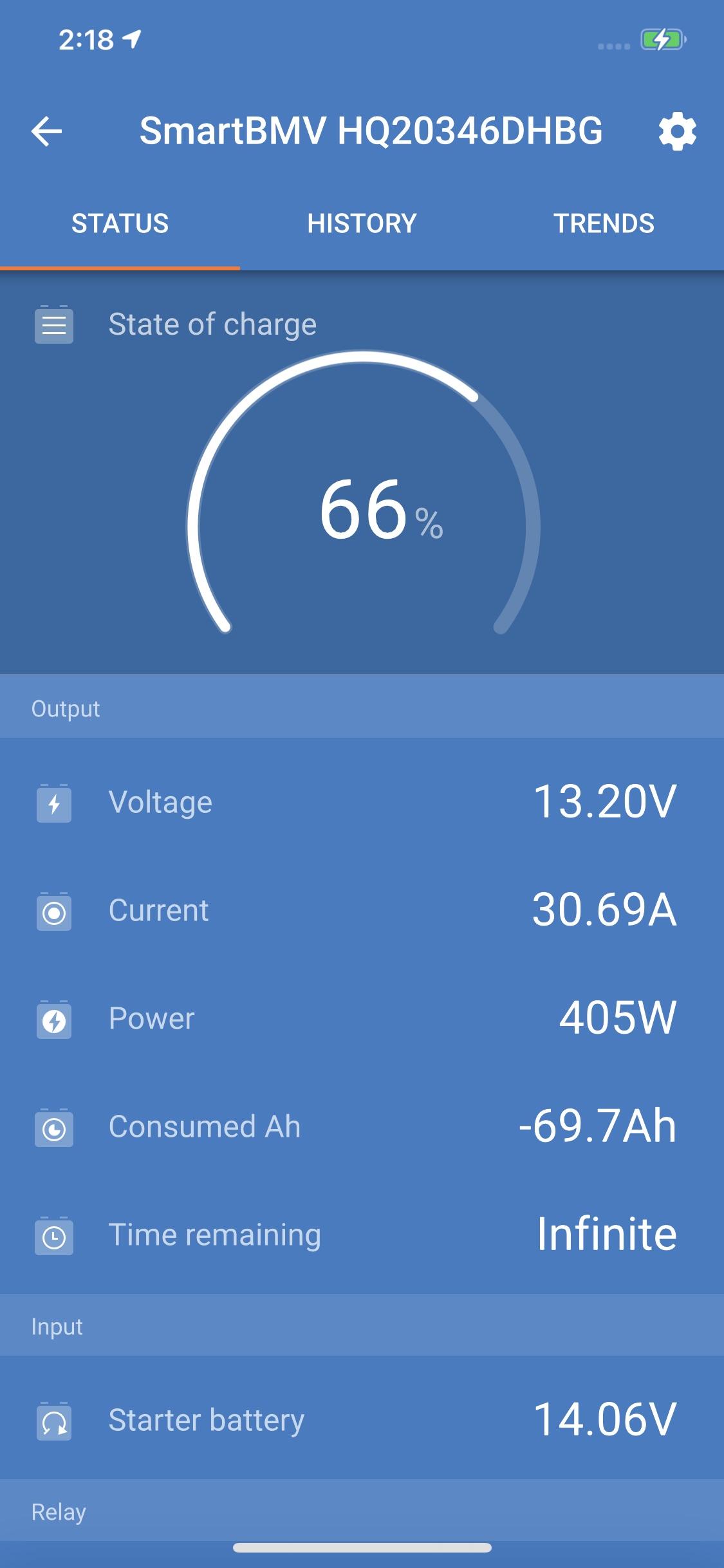

The easiest way to test the house batteries is to run them. Sit at the dock, fully charge your batteries. Disconnect from shore power and run a handful of things. The refrigerator, the radio, the chart plotter. If you had a battery monitor installed it'll keep track of how many amp-hours are consumed. I did this to my boat and got to -8amps-hours consumed and hit 10.01 volts at 97% state of charge. Full charge to empty in 8 amp-hours. That's a bad battery. I repeated the test for the second battery and got the same result. It was exactly 30 minutes of run time on each battery. My batteries were toast. They both did pass a battery tester, by the way. Battery testers test cold cranking amps needed for starting the engine, not deep cycle. The only way I know of to test a deep cycle battery is by using them and seeing how long they can go.
