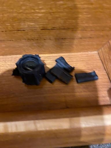

Agreed. My generator had 12 hrs when I purchased the new to me boat. Had it shut down on me a few times. Wasn’t sure what was the cause. After confirming oil levels, etc. I took the impeller out and saw this. I counted all the parts and non made their way into the cooling circuit. The previous owner likely ran it with the peacock closed at some point. As you said, cheap insurance.
