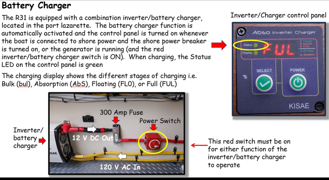

On day 1 of the Loop, R31 CB, 2023, standard batteries. Trying to use inverter at anchor. Kisae.inverter will only work if generator is running or shore power plugged in, but blank screen otherwise. No error messages. Just will not turn on. What am I missing?
Also check the big red rotary switch
Yes, it works fine when connected to shore power or when generator is on. But the point of an inverter is to be able to use stored 12v energy from the battery bank and use 1110v for brief periods, without using shore or generator power. When I am at anchor, I should be able to use inverter to run the microwave, for example.

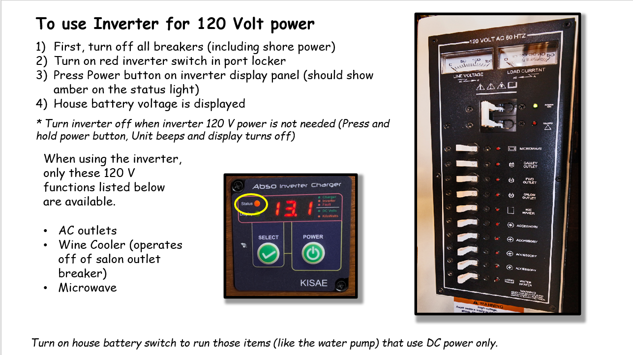

For sure. I think the two main things to check are
1) Red rotary switch on - needs to be on for inverter to turn 12V DC to 120 V AC
2) Kisae control panel power button on on
Maggie Anne, these are excellent instructions. Where did you find them? Thanks in advance.
Hi Todd, They are found on the customer care section of the Ranger Tug website
