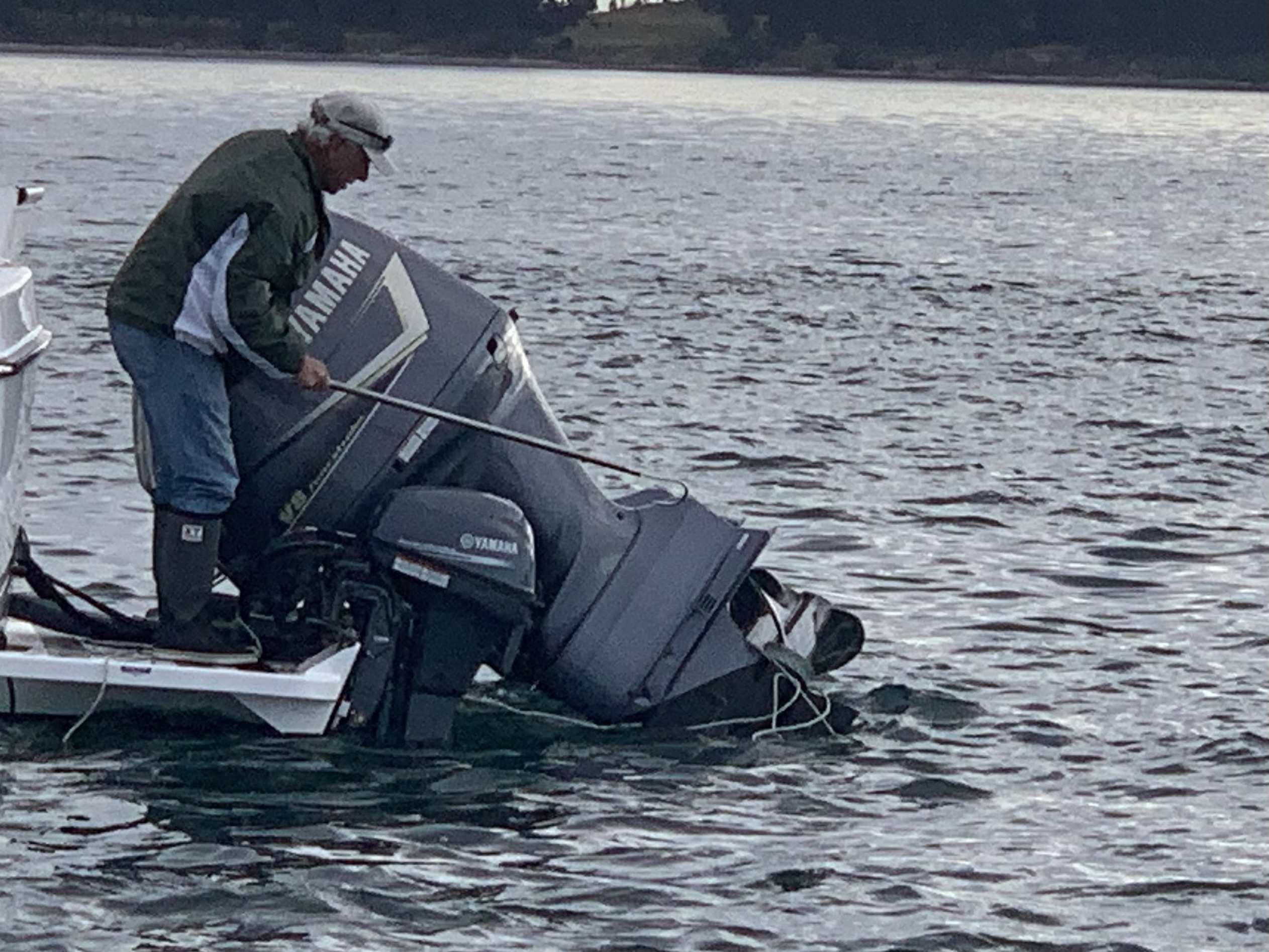

I took this picture several years ago, West side of Spieden, shrimp season. The boat's an Oceansport with twin F300's. He anchored himself on his pot, line wrapped around his prop. From his stance on the boat, he wasn't able to get to it and was stuck. I offered to help, but he'd already radio'd one of his buddies to come over on a boat to unwrap the leaded line from around his prop.

That picture gives me chest pains.
