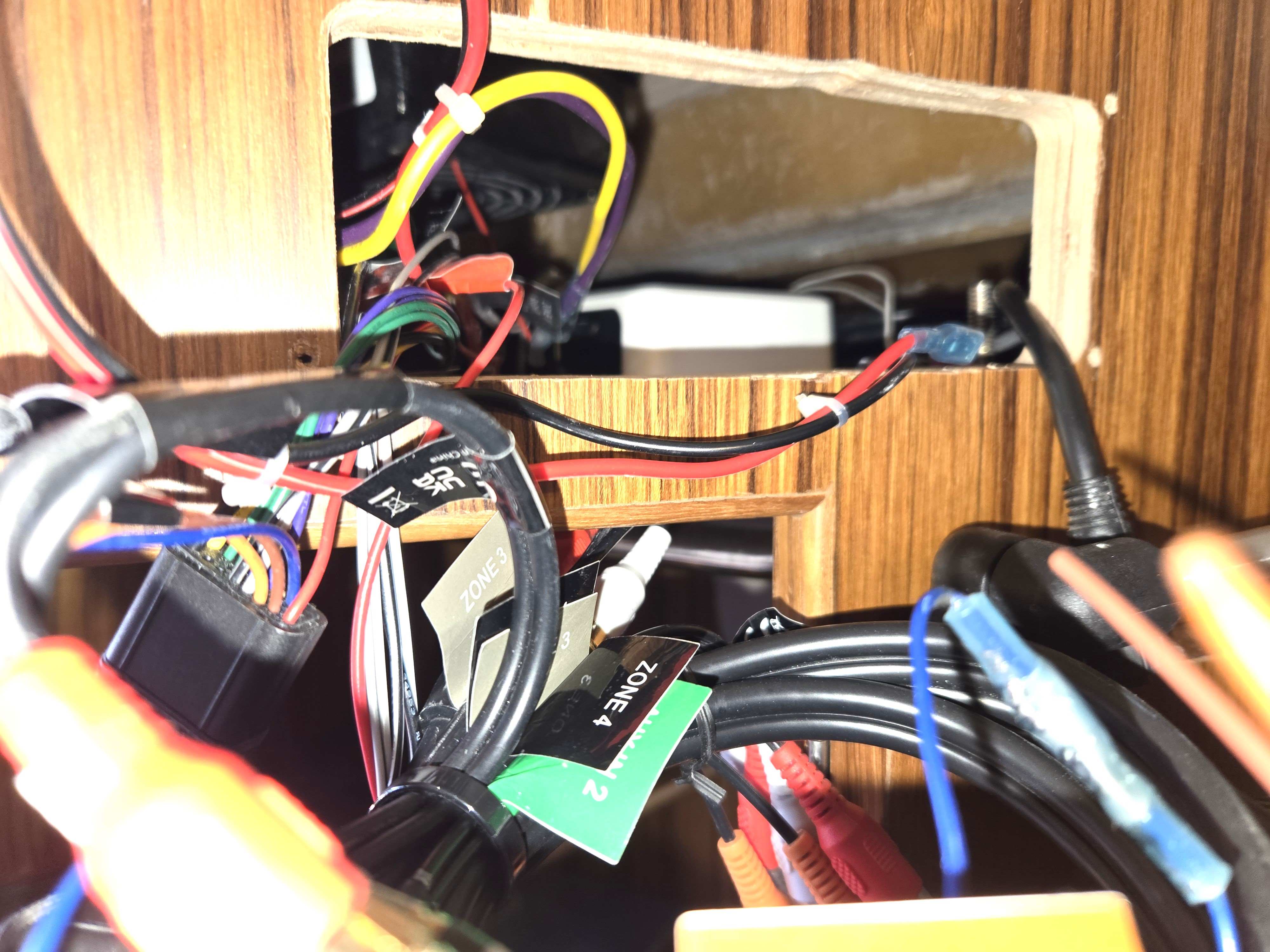

I realize this is a long shot, given the difference in model years between my boat and yours, but may I ask where, exactly, was the booster? I’m looking for mine in my 2026 R29 CB. I dropped my centerline ceiling wood panel and found nothing but wires and cables.
