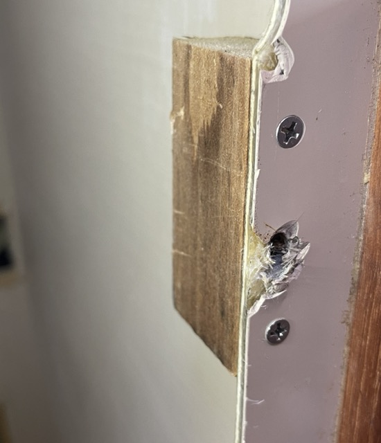

The previous owners of my boat trailered it A LOT and I could see that the screws had stripped out before. Their fix was to just jam a bigger screw in the stripped out hole. I could not fit a bigger screw through the refrigerator frame. See the attached photo to see how badly the screw holes were stripped. I vowed to make a permanent fix when I returned home.

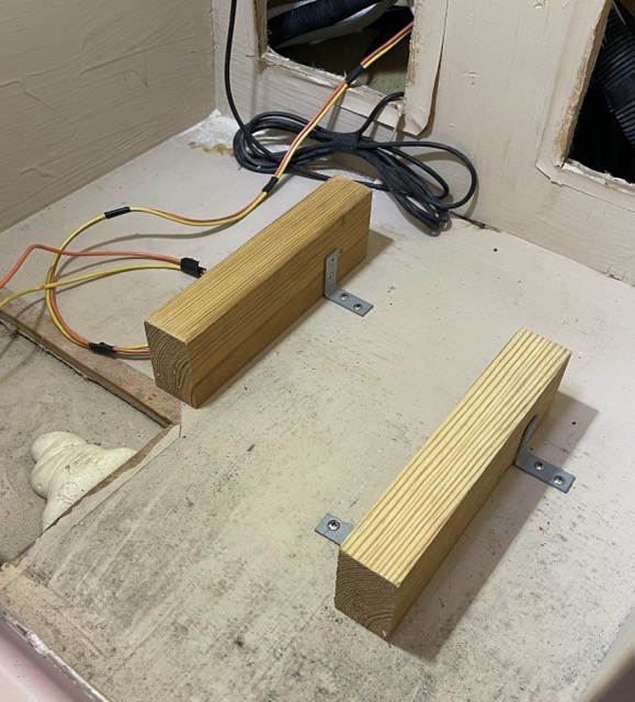

I’m no engineer, but I knew I had to fabricate support for the bottom of the refrigerator to relieve the stress of towing over rough roads. I accomplished that by ripping down a 2x4 to the exact height of the bottom lip of the refrigerator opening and then cut it in half to form a pair of supports. I fastened them in place with L-brackets secured by SHORT screws so as not to penetrate anything below the plywood bottom in the space.
I also knew I had to create something for the mounting screws to bite into behind the thin fiberglass surrounding the refrigerator opening. I cut some scrap wood that was the exact width needed to make screw receiving blocks. I secured the blocks into position with countersunk screws to maintain the flat surface of the refrigerator opening.
See the attached photos. The woodwork is pretty crude, but it’s a vast improvement over the OEM solution and I’ve not had any more issues with stripped refrigerator securing screws in the eight years and thousands of towing miles since I made the mod.
