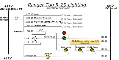

Just discovered this last evening. Our anchor light comes on when the switch is in either the Anchor or Navigation positions. However, neither navigation light (port/red and starboard/green) comes on. My initial thought is that this isn't a fuse (since the Anchor light works). However, I did replace one of the navigation lights last year. I suppose it is possible they both went bad at the same time. (I'll test that when I am back on the boat in a few days.). But what does the collective wisdom have to say? Thanks!
