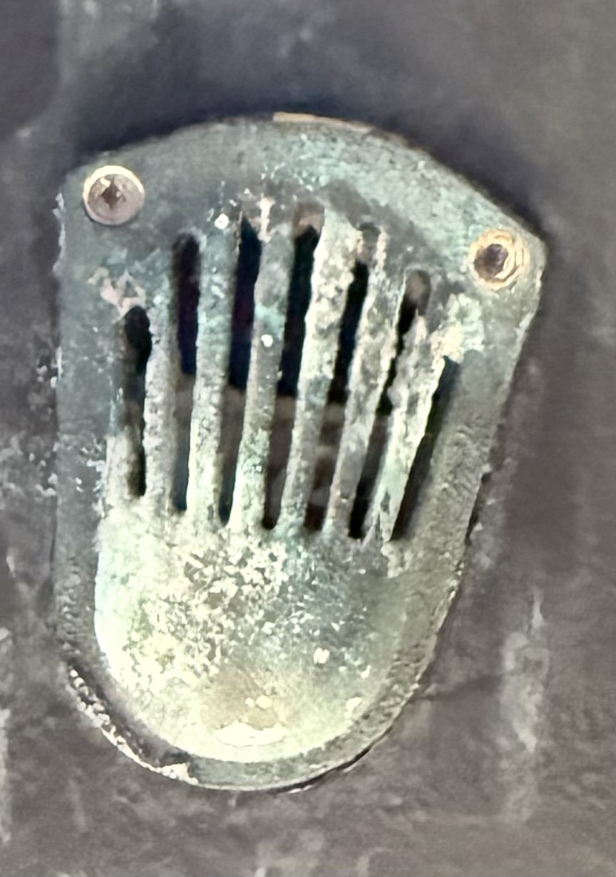

The Owners Manual shows a line coming of the starboard side sea strainer going to the head. (And yes, my boat has both a port side sea strainer and a starboard side sea strainer.) My C-28 has this line coming from the sea strainer with a 90 degree ball valve next to the sea strainer to shut the line off.

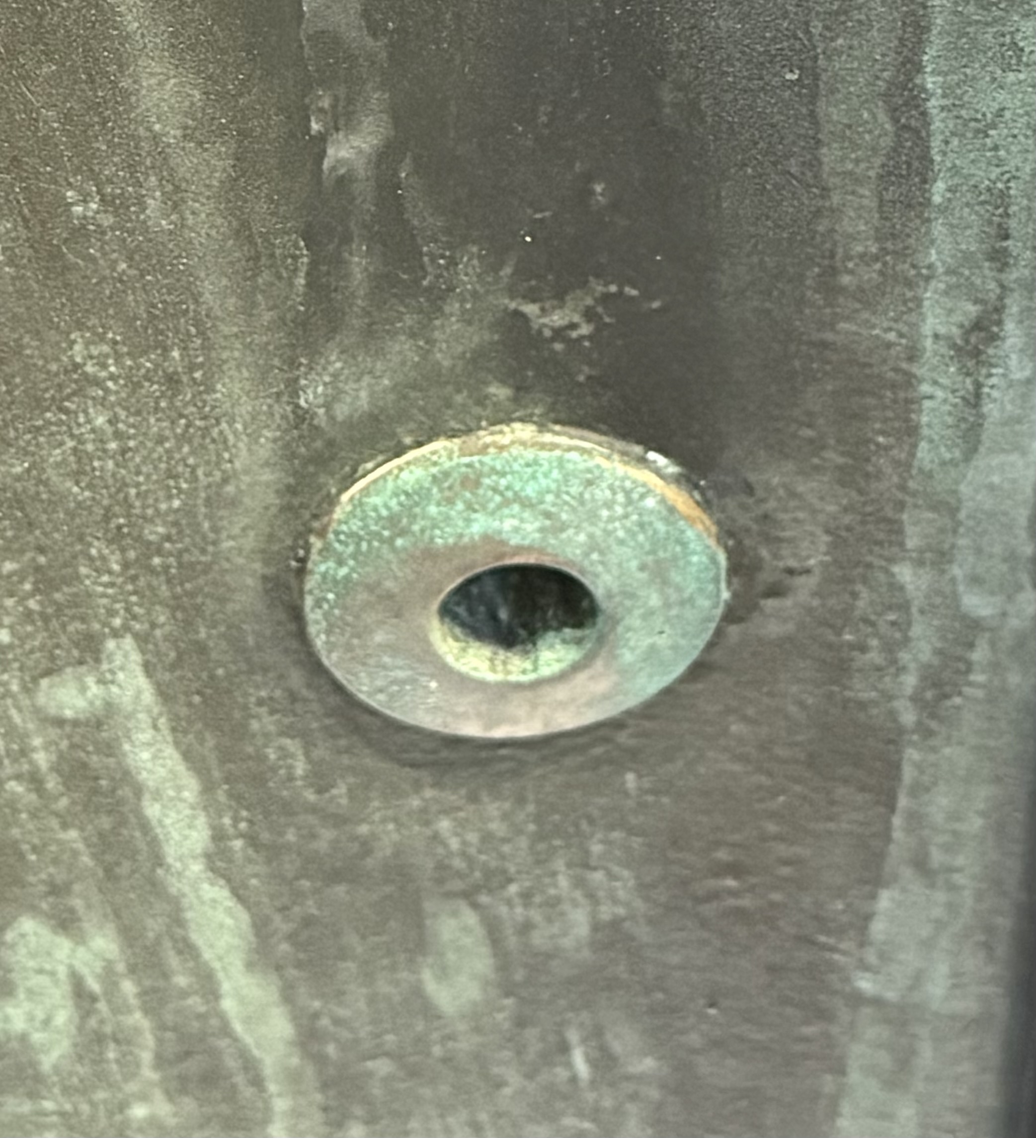

I also have a separate through-hull with a line that goes to the toilet. This line also has a 90 degree ball valve installed to shut the line off. The through-hull is NOT referenced anywhere in the Owners Manual.

The “scoop” on the through-hull used by the starboard side sea strainer has a positive pressure to it at high speeds and has forced sea water into the toilet when at high cruising speeds. And yet, that’s what the Owners Manual states as the proper source for sea water to the head!

For normal operation I’m assuming I should be using sea water from the independent through-hull. I think the through hull has zero pressure at cruising speeds and therefore won’t flood the electric toilet.
So, just only use the sea strainer sea water feed for winterizing and use only the independent through-hull for normal operations????
