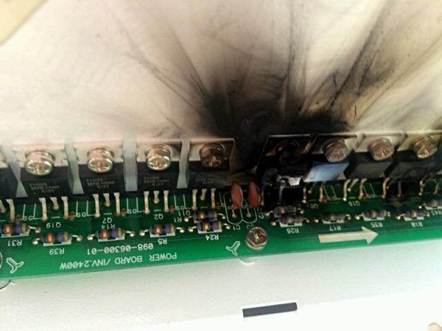

One of the issues with overloading is in the event of a power failure at night or during the day while away for a while. If you have heat on and the water heater , if there is a power failure the inverter automatically comes on and does what it can to keep up... This could be happening with out any one knowing if the power is restored before you return or wake up . This can be overloading the inverter unintentionally .. I have also been at marinias where they have a 30 amp receptical and only 20 amp breakers... Using your normal loads can result in blowing the breaker and the inverter takes over.. Because it is an instant transfer it does not get the start up loads and will run a fair bit of load. In my case two heaters and the charger.
I'm thinking this could be the cause of some failures that you may not be aware of.

No , on mine if the power is interrupted it automatically starts working if it's up in the shore power mode.. Perhaps it came wired wrong .. But that always how it's been.. If there is no load it just flashes no power.. When out at sea I need to put in down to inverter to use inverter , up if we are using the generator.. Switching it up from the off position if no shore power does nothing . But as I said if it is under load and the power goes off it automatically starts inverting... I should check the manual .. Maybe it is wired wrong
Given the sensitivity of modern electronics , why would a "square" sine wave inverter be supplied ? I can speculate, but perhaps it just cost less at the time. I do hope Ranger is having a conversation with Pro Mariner on this subject. Ranger and/or Pro Mariner should consider offering an upgrade at a reasonable cost to any owner that might be interested.
I know most equipment on the boat comes with a 1 or 2 year warranty, but owners expect the working parts to last for longer than that... and in most cases the pumps , electronics etc last for years. Given the sophistication and cost of some items (inverters) such warranty periods should be longer. The boat manufacturers should ask for longer warranties and the product manufacturers should provide it.
It is more difficult to create a better and better approximation of a true sine wave so a manufacturer charges more for that. There is more digital electronics in order to accomplish that so perhaps that is why the circuit in the PS model appears to be better protected for a high amperage load.

Our Pro Mariner failed last spring when we used the microwave to cook two hot dogs for my granddaughter. We were getting a week verse polarity light when on shore power. Turned out that the inverter welded the green safety to the neutral and instead of opening the connection when the inverted was turn off they stayed connected. Installed a Magnum MS 200 Pure sine wave inverter/charger to replace the Pro Mariner.
According to the ABYC Technician, who put in the new inverter, the boat was suppose to be wired so that only those AC devices that the inverter could handle were available when the it is turned. The boat was wired so that the incoming AC went directly to the inverter and then back to the rotary AC, Generator and Off switch. Rewired the incoming AC to the switch and added a separate neutral buss with just the AC outlets and the microwave. For some reason, had to do with the boat wiring, it worked but got a very faint reverse polarity light when the shore power was turned on. So rewired it the way it was originally wired with the AC going to the inverted first then to the switch. Will try and trouble shoot it this spring.
So we still have to manage the inverted so that only the loads it can handle are turned on. Our protocol is to first turn off all AC rocker switches and when the inverted is turned on to switch back on the AC outlets and the microwave.
The Magnum is capable of switching the inverter on when shore power is lost, but that option is disabled.
