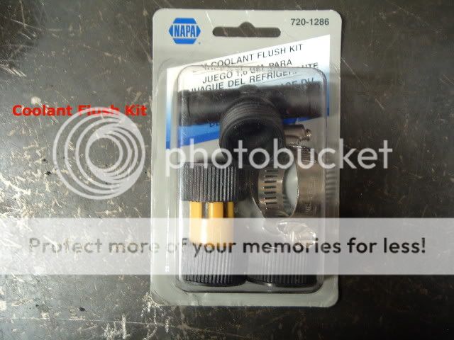

Two of my R21EC's had the Yanmar; the present one has the Volvo. I did the maintenance work on the first Yanmar: adjust valves, align the shaft, change oil, change filters,etc.. Never had call to do any work on the second Yanmar. My Volvo has 42 hours, I drained the oil on Monday, couldn't get the oil filter loose by hand. Will take my trusty oil filter wrench and change the filter today. Can see no difference in those tasks for the different engines. The one thing I didn't/don't like on the Volvo is the setup on the fresh water supply line. The Yanmar setup had an easily accessible fitting installed just past the fresh water filter and below the pump where one could attach a hose and flush the system; or pump antifreeze thru it (a one person operation). The Volvo system is more complicated. One has to tap in (after finding an appropriate fitting) past the fresh water filter; and there's only a short hose with not enough space to install a fitting (and it would be ackward to attach a water hose.). So, the best solution is to mount the filter higher and use a longer hose. I believe SGIDAVE did that when he replaced the engine/battery bulkhead. I'm not sure I can do the remounting on my standard engine/battery bulkhead (lack of space?). Meanwhile, my wife has helped me run antifreeze thru the system via the fresh water filter. I pour antifreeze into the filter housing; and she manages the engine controls and monitors the output thru the exhaust.
