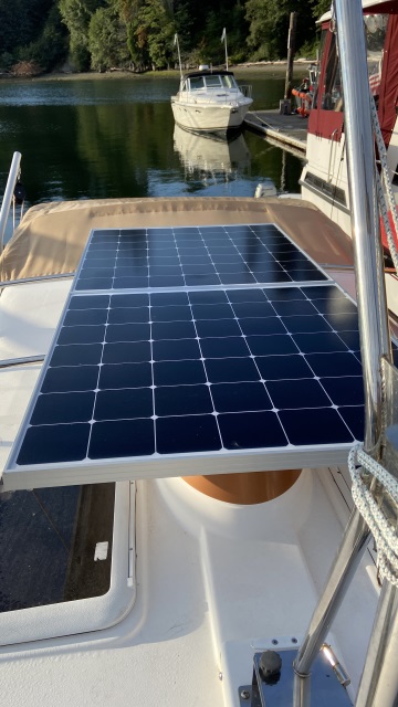

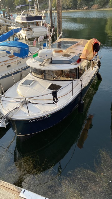

The stock panel on our 2018 R23 is a paltry 90 watts, which didnt even fully keep up with the refrigerator running. We are not super heavy electrical users, but I wanted to make sure we would be energy independent, so I decided to upgrade to 350 watts via two 175w Custom Marine Products panels. The 175w panels are square shaped, which would make them take up a lot of space if mounted side-by-side, so I decided to mount them front-to-back, essentially making a big rectangle. This allowed me to keep the sides of my rack free for other uses. In order to mount them, I used some aluminum channel strut (aka Unistrut) - I bolted the two panels to each other and then to the channel strut to make one solid unit. I chamferred the ends and used the Gemini rail mounts to attach to the roof racks.
I am really happy with the way it all turned out. It just so happened that @Submariner was visiting the Langley marina the day I got these installed and I think I even got his seal of approval =)

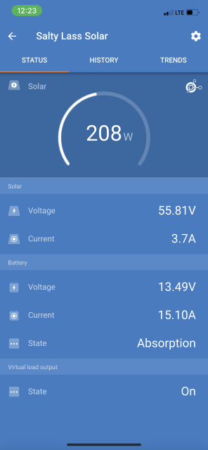

Here are some of the numbers from yesterday - it was pretty sunny, but there was some smoke in the air and it is the tail end of September in the PNW. For reference, I had never seen more than about 60 watts from the old panel on the brightest sunniest day with the old panel.
(NOTE: It is obvious in hindsight, but one thing I learned the hard way: the MPPT controller can output up to 30 amps (that is why it is called 100/30), so the fuse between the controller and the battery needs to be sized accordingly. The stock configuration included a 10 amp fuse and my old PWM controller and 90w panel never got close to that. With the new panels and controller, I blew the fuse when the sun was out and energy was flowing into the battery. Since my wiring was already 10AWG, I replaced it with a 30amp fuse and all has been fine since,)

Beautiful job, thank you for sharing. Do you have photos of the wire run? I’m about to install panels on a 2017 w/o the factory system. Also, did you consider flex panels mounted on the canvas?
My boat already had a stock panel, so I just reused the wiring. The whole operation consisted of cutting the wires that came up out of the roof, crimping on the MC4 connectors, and plugging the new panels in (mine are wired in series). As far as I can tell, the wires run down the aft port corner of the cabin to the electrical panel (that is where the stock solar controller is located).
I did consider the flexible panels, and Custom Marine Products has some flexible panels that look really nice. I thought placing them on the canvas would be a good idea since it would keep the roof rack free. But in the end I liked the rigid panels and mounting options on the rack, so that is what I used. I would love to see some pictures of flexible panels installed on the canvas though.
Regarding wire run, on my R23, the solar wires ran to starboard side to the port window wire run, down behind the galley, under the floor and up to power panel and solar controller. It was a little challenging pulling wires under the floor as they wanted to get stuck on edges.
For my R23, I built a rack that sits on top of the bimini for the solar panel. That allows use of the cargo rack for rocket box, kayaks and crab pots. It also puts the solar panel in a location less likely to get shaded but adds more weight to the back end of the boat.
