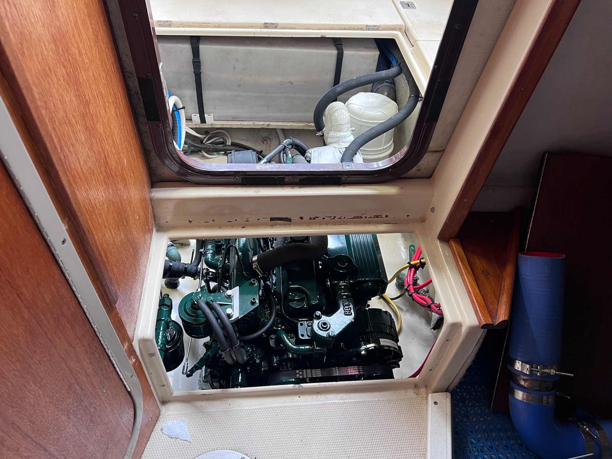

The (2016) R27 I made an offer on last month did not make it through engine inspection, and I pulled the offer. Long story short, I really like the boat, but would only consider it with a new or rebuilt engine, and while Volvo does still sell D3 blocks, the shops I've asked all say not to touch the D3, and to go for a Yanmar 4LV. The overlay drawings one shop sent show that their dimensions are close, and at least the front mounts maybe in the same place.
I'm preparing a new offer accordingly, but searching the forums, I find no posts about a real-world experience of replacing a D3 with a Yanmar on the R27?
Has anyone done it? If so, can the boat handle 230 HP, or is the 195 all you want? New gearbox too? The exhaust was workable? Any recommendation on a shop (in Washington or BC) that's done it, and may even have jigs? What sort of cost am I looking at? Bottom line, is this a walk in the park, or is it going to be a first?
