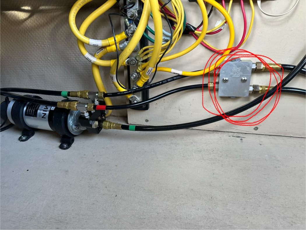

2014 R27 Classic. Had the same problem. Garmin replaced the pump under warranty first. No go, (i,.e., A new 1.2 pump is not a solution). The factory sent me a check valve kit. I installed the check valve myself and bled the system. The steering has worked perfectly for 4 years now. Completely solved the problem.

It can be tricky to fully bleed the autopilot pump without a power purge system but it can be done. If you install the check valve yourself and have difficulty purging the pump send me a private message and I’ll walk you through what I did.

Photo of new Garmin check valve install for future installers.
I sea trialed and the manual steering is about 75% better… I am guessing the last 25% is prop walk. It was a wicked windy day.
