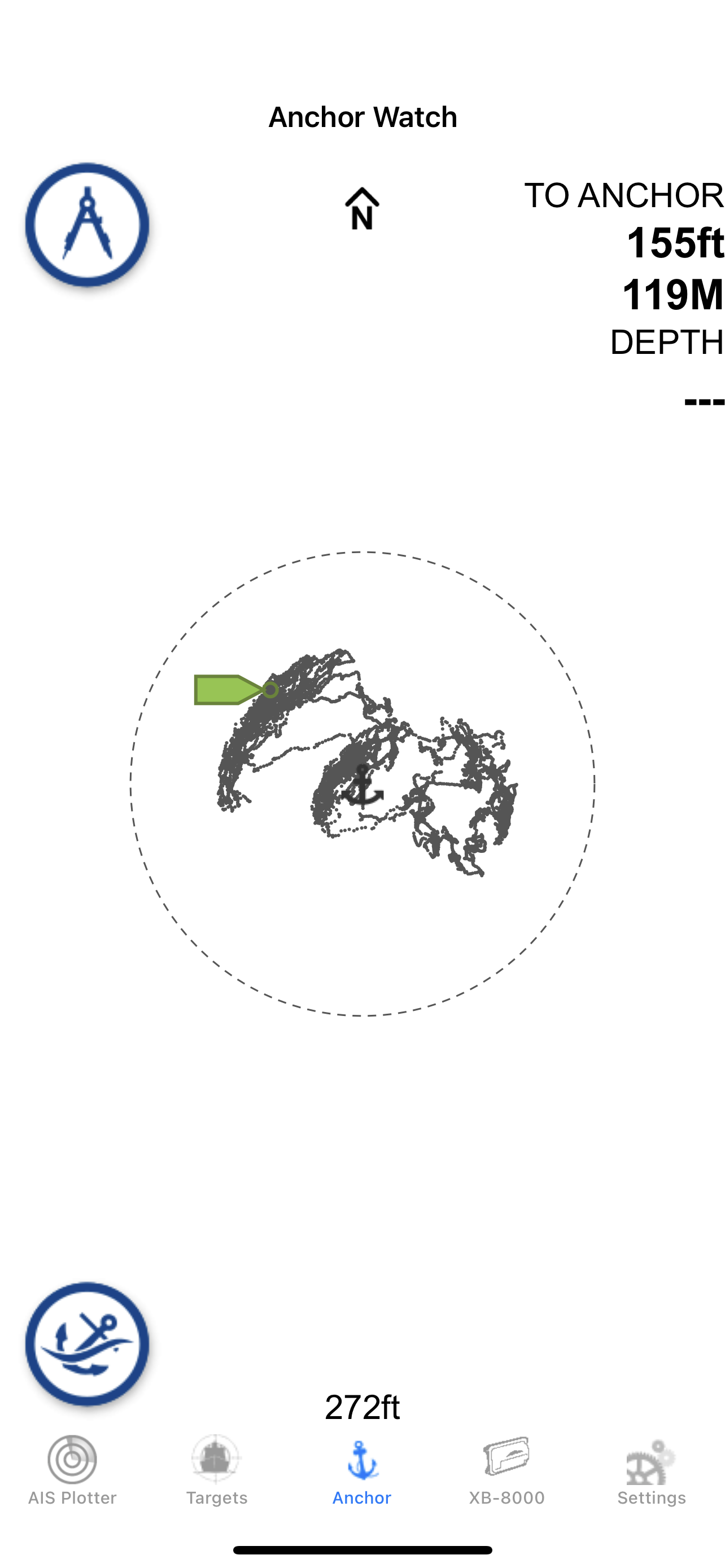

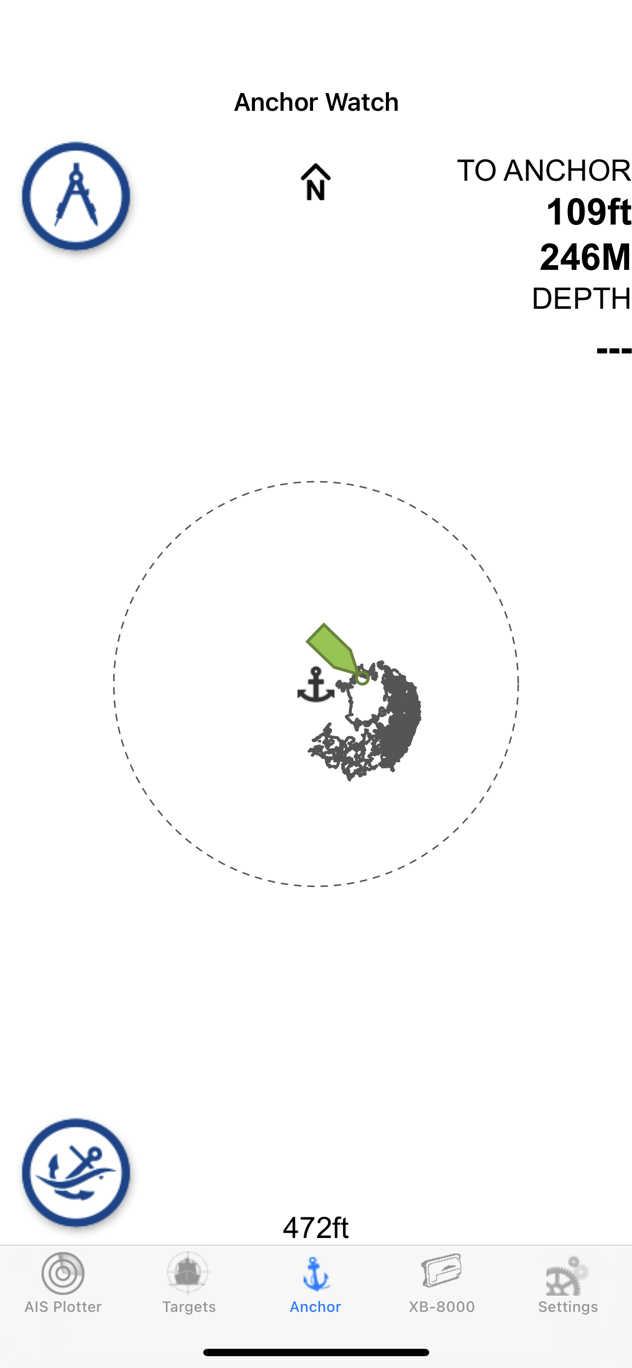

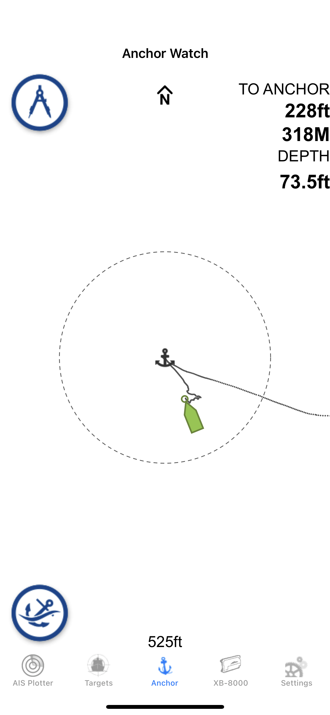

I often will turn on Navionics and set it to "track" the route while at anchor. My anchor drag alarm (built into my Vesper XB-8000 AIS unit) also tracks the boat's movement while at anchor.

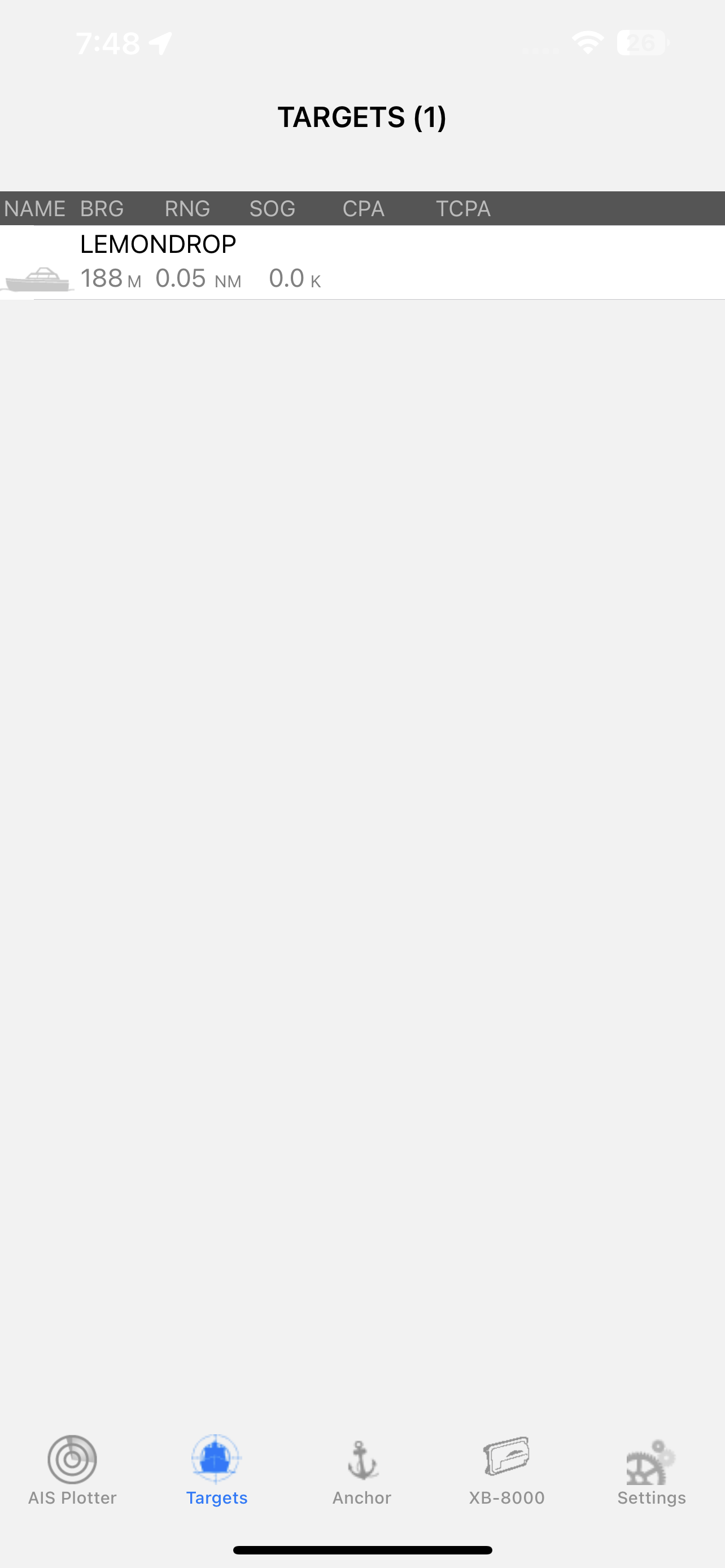

A look at AIS showed that I only had 1 other boat nearby... Lemondrop! (nobody else was within 14nm of us. We had plenty of room Lol).

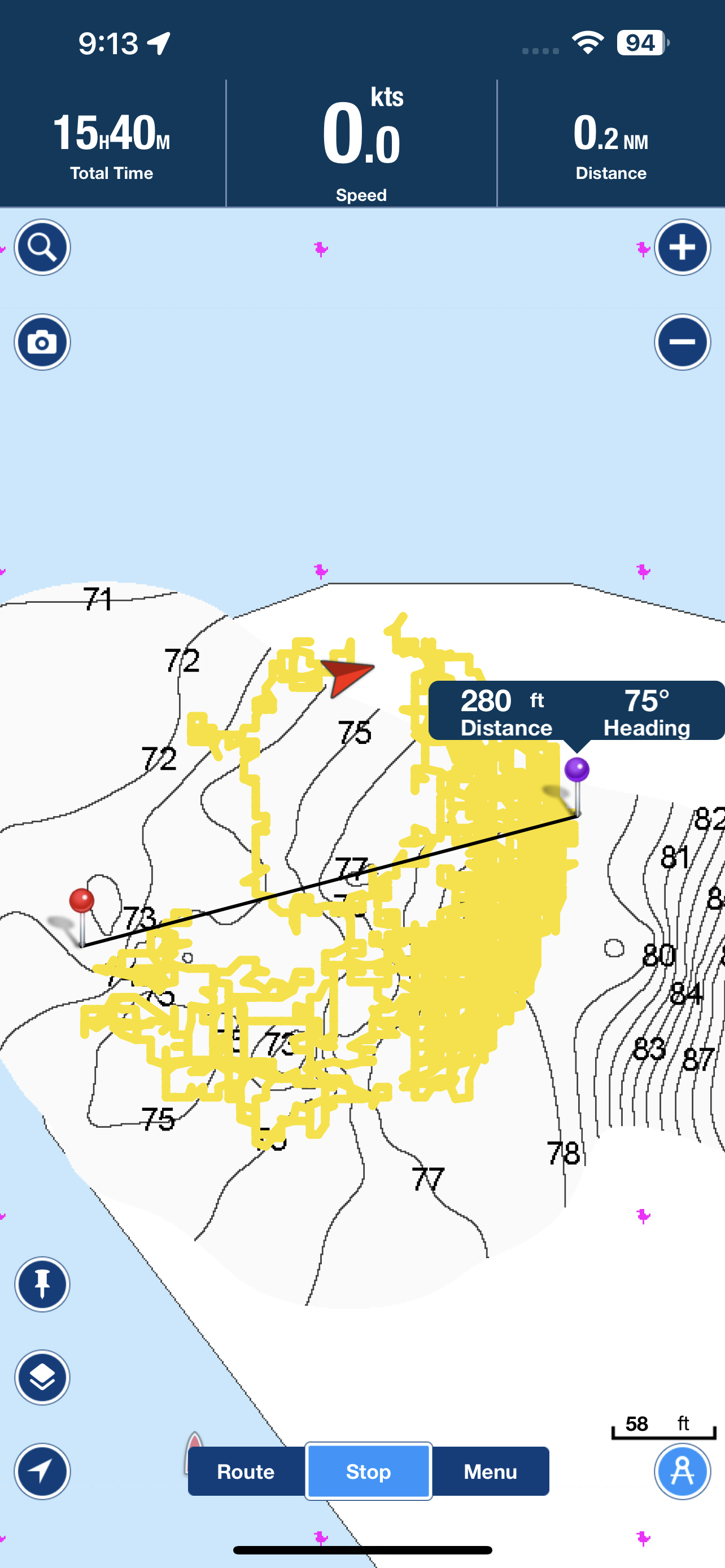

Here's a screen shot of my track at anchor after 2 nights.

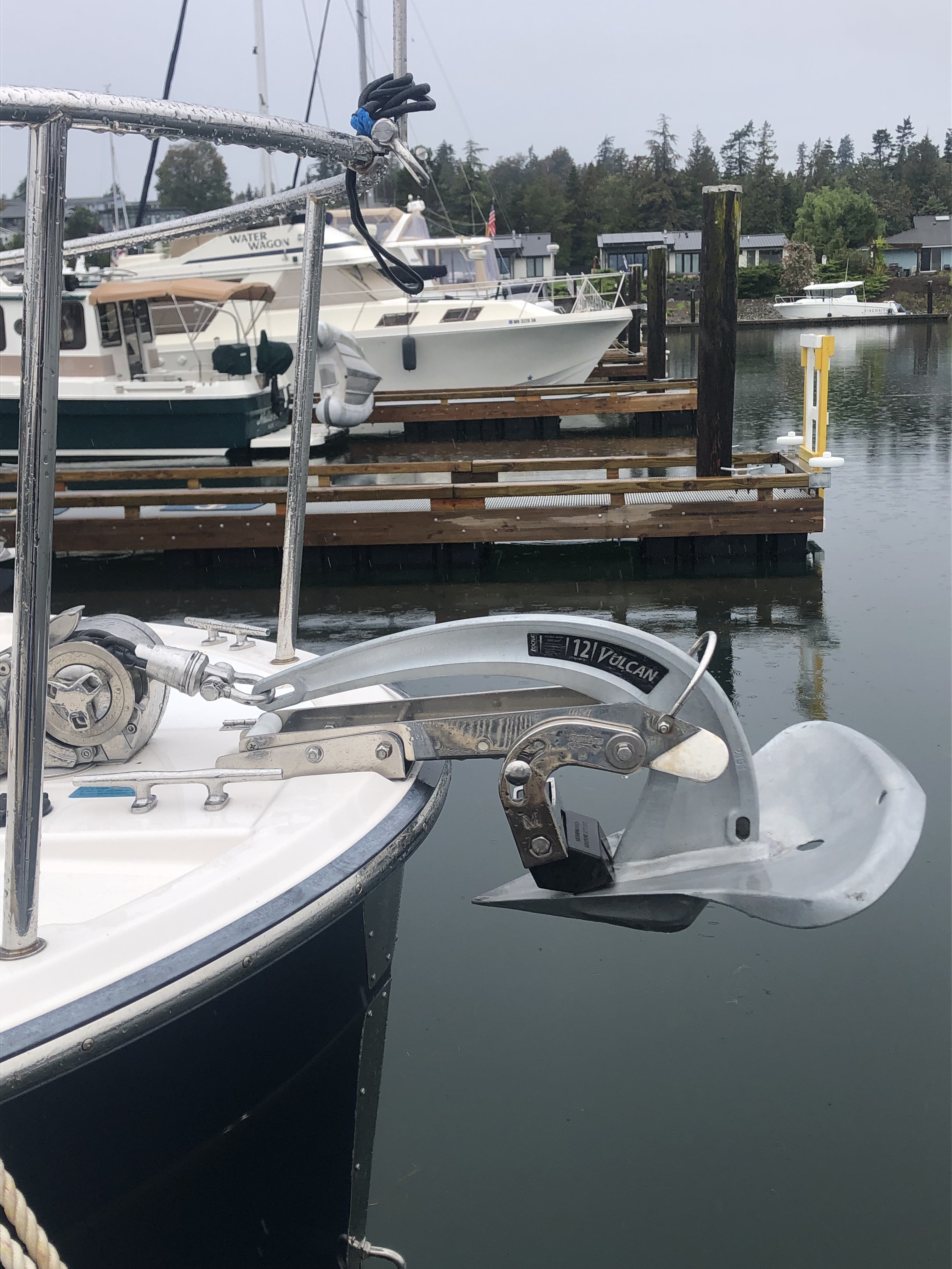

I am happy with a Vulcan 12 on my 27OB.
One thing that we want to do more of is sleep at anchor. We have only anchored a few times and always just for brief periods during the day. I’d like to reduce our “marina hopping” and spend more time away at anchor.
I know that there are skills we will need to perfect, and strategies to learn, but having confidence in the anchor is a big part of being able to sleep at night. The OEM Bruce seems “ok”.
I see people put the Rocna 10 on R27s as an upgrade. Why not the 15? Is it too big? Bigger is better with anchors, no?
Here is a pic of the Vulcan on our 27.
ditto on the vulcan, our vulcan 9 is like a dagger and has held 4 boats without dragging.
Many thanks @Rebel112r and @sfladgard for the info on the vulcans. I’m going to pull the chute on the first good deal on a R10 or V9/12 I find.
