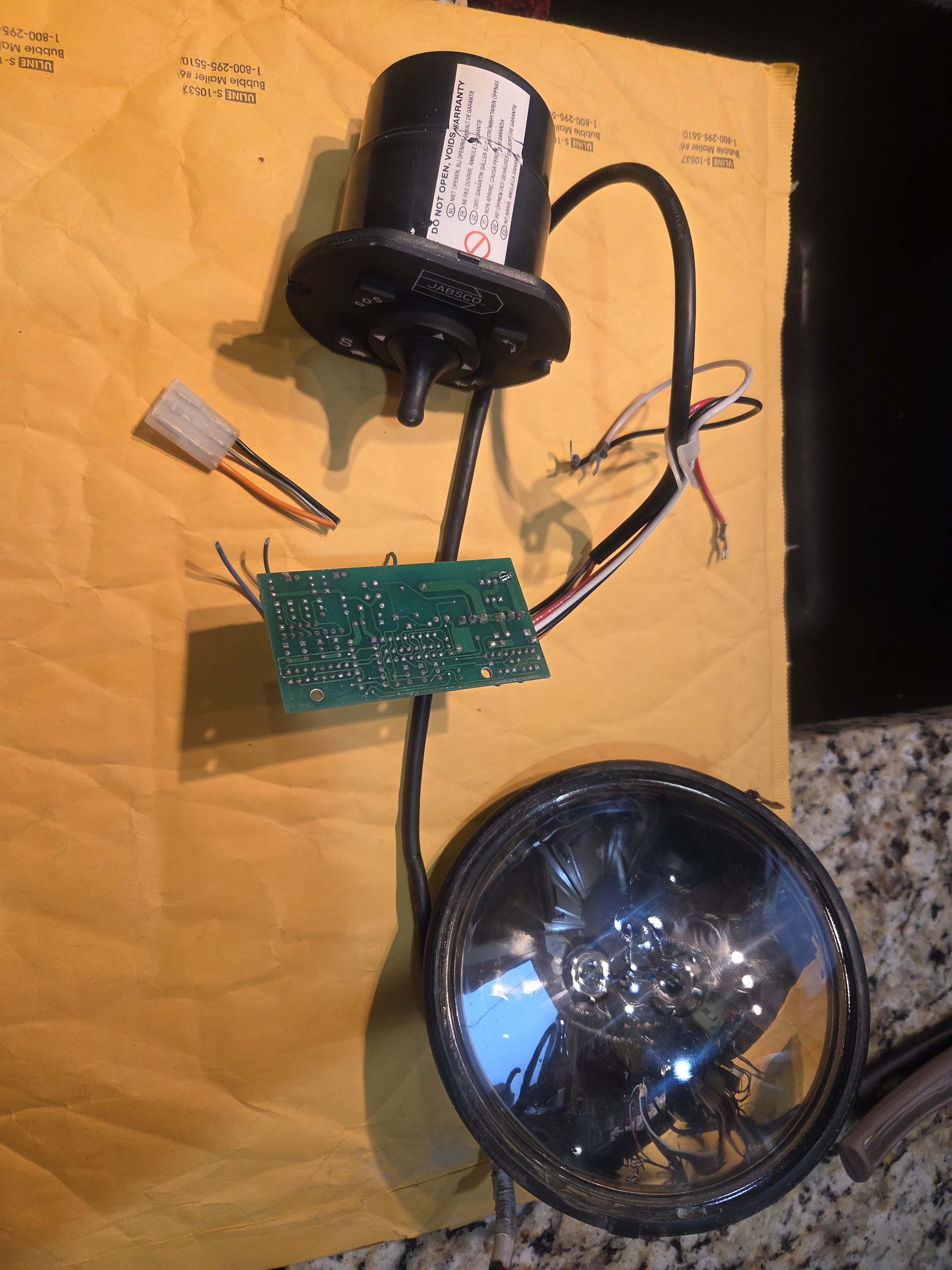

I have a 2013 Ranger Tug R-29 Classic whose searchlight (Jabsco model 63022) has ceased working. As the motor and controls still worked I purchased a replacement bulb for ~$60, but prior to installing it the direction controls ceased working. ChatGPT believes it’s the PC board that has failed—13v power gets TO the PC board but no workable voltage comes FROM the PC board. (I understand one can bypass the board to supply 13v power directly to the bulb, but that won’t address the control motor issue.). I have heard Jabsco is exiting the searchlight business and has not responded to my requests for parts, nor has Ranger Tugs. A marine supplier offers the motor and board for $368 + shipping.
Can anyone recommend a solution here for repair or replacement? Should I continue pursuing repair, or are there replacement solutions anyone can recommend?
