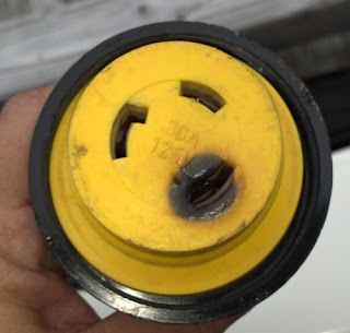

Anyone have this problem? I have a new 2020 Cutwater 24 and when I turned on the heat the first time last weekend, the shore power cord got so hot that it melted the prong from the aft plug right off and into the cord. This was at the boat receptacle, not the shore power on the dock. Both ends were tightly screwed on and I had no other issues all summer long when I had it plugged in to shore power.
