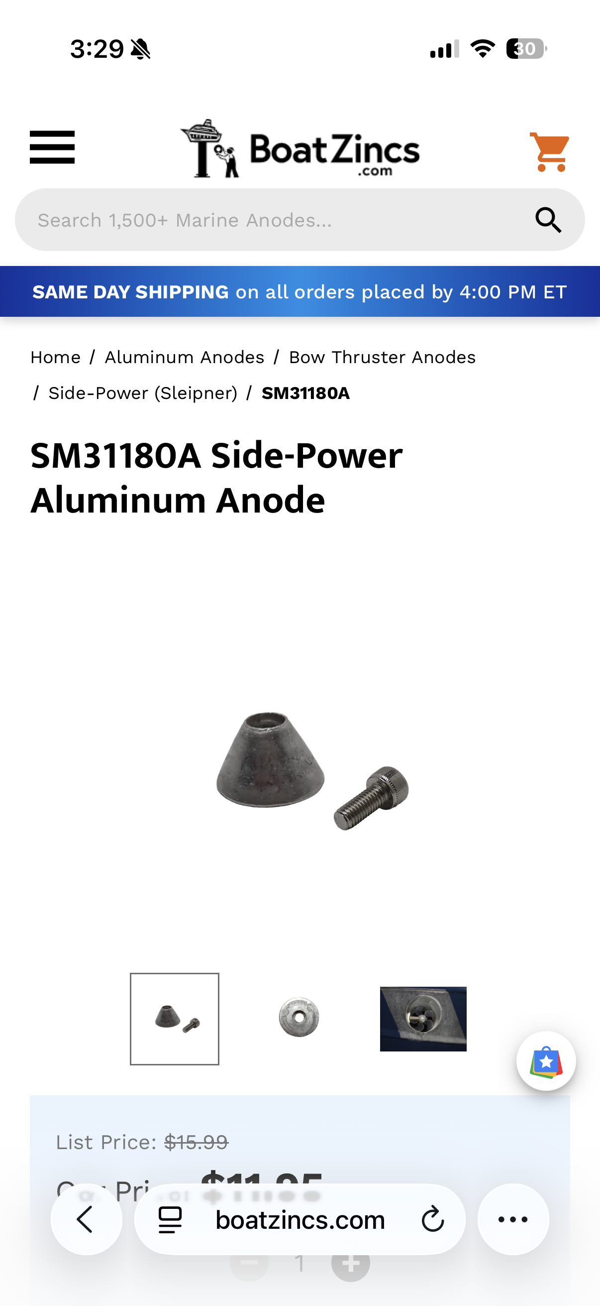

Our new to us 2019 C28 has no anodes on the bow and stern thruster propellors. It looks like they may have have been present in the past, but have completely degraded in salt water. Does anyone have a part number or dimensions for these zincs? I assume they are conical in shape and held with a stainless hex nut to the propellor shaft?
BoatZincs dot com. If you have the Side Power thrusters the part number for the aluminum anode is SM31180A Side-Power Aluminum Anode. My 2017 C-28 has the Side Power thrusters. Check yours to be sure. And understand the differences between aluminum, zinc and magnesium anodes. I’m all aluminum for longer life in salt water.
Yes, anode secured with stainless bolt. You get new bolt with anode purchase. Bow thruster anode bolt can be difficult to reach. Stern bolt is much easier. Once old bolts out it’s easy to install the new anodes and bolts.
